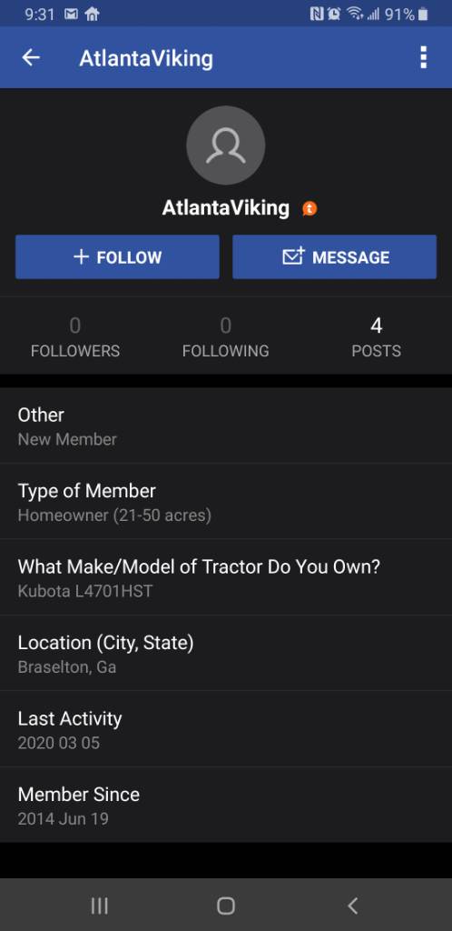

I fear the OP has left the building, so we are left speculating based on the scraps of information we have. Perhaps there were no warning signs, but if it got hot enough to lock up the engine, I wonder:

Only 4 post & no activity in 2 days. Been a member for a while though. I expect he didn't like what he heard & isn't comming back as well. Screenshot_20200307-093155.jpg

Only 4 post & no activity in 2 days. Been a member for a while though. I expect he didn't like what he heard & isn't comming back as well.View attachment 644300
Probably not. He came here for sympathy not a viable answer. If I pulled a shot like that, I'd never fess up to it on a public forum. If I knew where he lives, I'd send him a diaper.:laughing:
