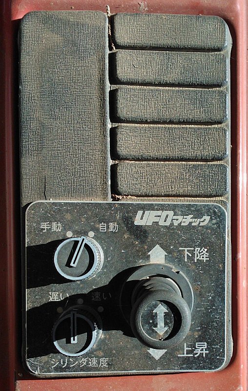

Okay, I finally got around to snapping a pictures of the control in question over the right rear fender. The large knob/lever to the right controls the up/down and tilt (side-to-side) of the 3-point hitch, but I cannot figure out what the two smaller knobs do -- if anything. I'm assuming they are for a tiller or some other attachment with sensors/control, but simply don't know (not being able to read Japanese). Does anyone know what the two smaller knobs on the left do and/or whether they are of any use to me using simple 3-point attachments like my box scraper and/or a brush hog?

BOY, am I late to the dance or what.
See you've had good replies about the coolant level indicator. As for the UFO controls. Your controls are slightly different than mine. Only know from experience what one switch does. On mine, the switch in the upper left corner turns the UFO controls on/off. The UFO only works IF you have the related control box on a Yanmar tiller is present, plugged into the tractor, connector right above the right lift arm, the one with the hyd cyl. Basically the UFO keeps the tiller level. There is a cable/linkage setup that controls the tiller depth. You will need to have those items on the tiller. It connects to linkage above/fwd of the left lift arm. Tiller depth is then set via the "draft control".
Hope this belated response will help.

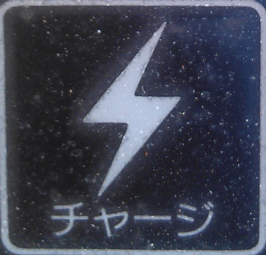

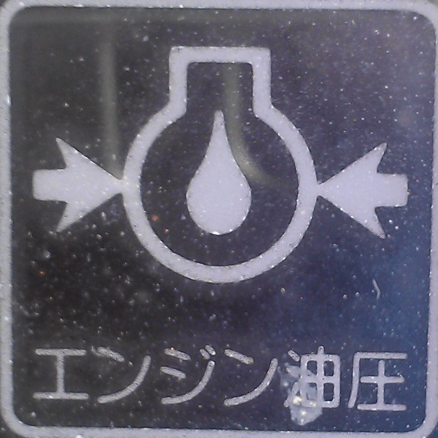

Same with my F22D. Good to know what it means. I didn't notice the light until at night when trailering the tractor home after purchase. Seemed to be related to coolant, but radiator was full, so ...
Speaking of warning lights, the glow plug and battery lights are pretty obvious. But there are two that I cannot identify and my Japanese is no good.
What do these warning lights indicate?
/ Warning light... #14
Same with my F22D. ... so ...
View attachment 286799View attachment 286800
1st is oil pressure
2nd is a charge indicator lamp
I think; If memory serves right

usually, telling you battery isn't being charged by the alternator
