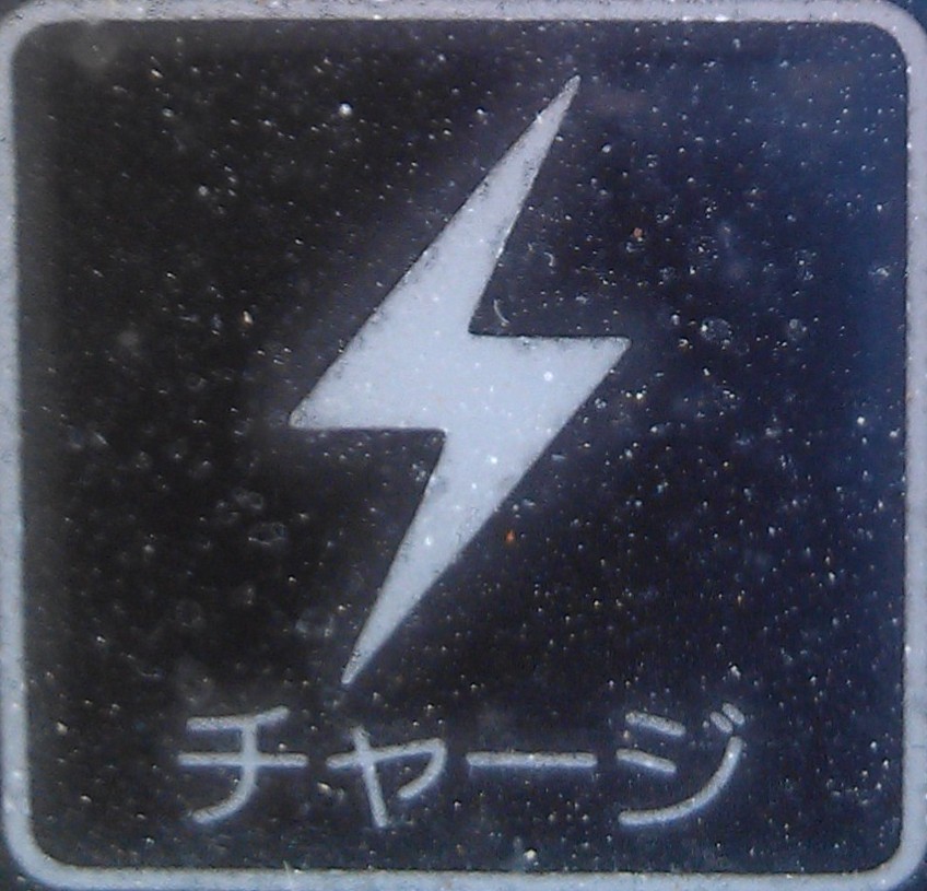

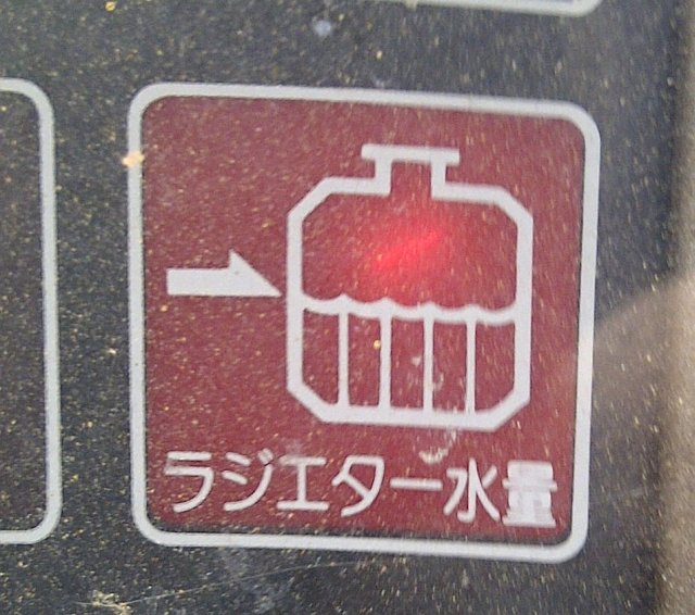

I just got a new (for me) Yanmar F18D that seems to run perfectly except it's got a warning light that stays lit. I can't read Japanese and haven't received my operating manual yet from Hoye, so I'm hoping someone here might know what the symbol stands for (attached). Any help would be appreciated...

coolant level. it is in the overflow tank.

Ah, so even though the radiator is full, the light could be on because of the overflow tank? I'll have to see what's up with that. Thanks!

Welcome, i also own a F18D, after buying mine, i found the lead that controls this light was disconnected, connected it up, and the light came on, filled the overflow and the light went out.

It was just needing some water in the overflow bottle. I had previously checked the radiator directly (filled and in good condition) but hadn't checked the overflow bottle. Light is out, I'm happy. Thanks!

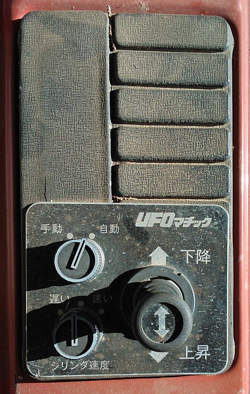

@scottlw, thanks for the offer! I guess there are just a few now that I haven't figured out... 1) the little button to the left of the steering column that, when pushed, causes a red light on the dash to light (looks like a picture of a battery); 2) the knob under the seat that says "easy" and "hard"; 3) the two knobs next to the lever to control the left/right pitch of the 3-point hitch (I assume they are for implements I don't have?); and 4) the lever marked 1-10 immediately to the right of the seat (next to the lever that raises/lowers the 3-pt hitch). I think that's draft control or something for a tiller (that I don't have)? Oh yeah, and 5) the pull knob below the left side of the dash. What the heck does that do?

OK, i can help with some of these.
1) i think this is a warning light test button, without the ignition on, press and all warning lamps should light (a couple of mine don't).
2) I think this is the speed control/shut off for the 3pt, I'm sure winston or somebody will explain this better.

4) I assumed this is draft control, don't think mine even moves?
