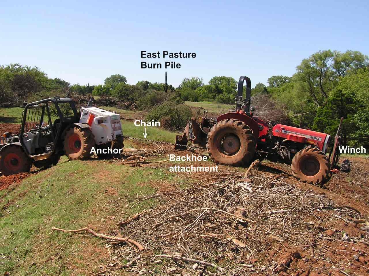

What about a Warn or other brand winch attached to the front of tractor?? Has anyone ever done this? Seems it could also be useful in extricating oneself from a precarious situation.
Thank you in advance,
Danica

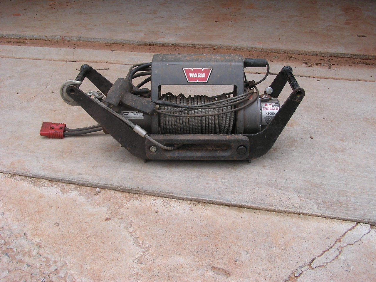

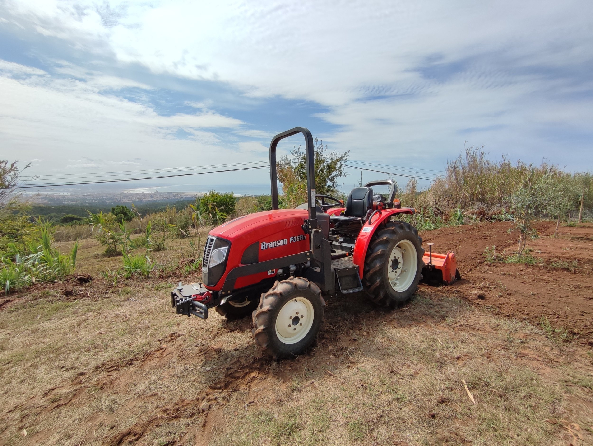

I did it with a receiver hitch on the front:

Awesome job! Thanks for ur response it is very helpful and confirms I’m not totally crazy!
