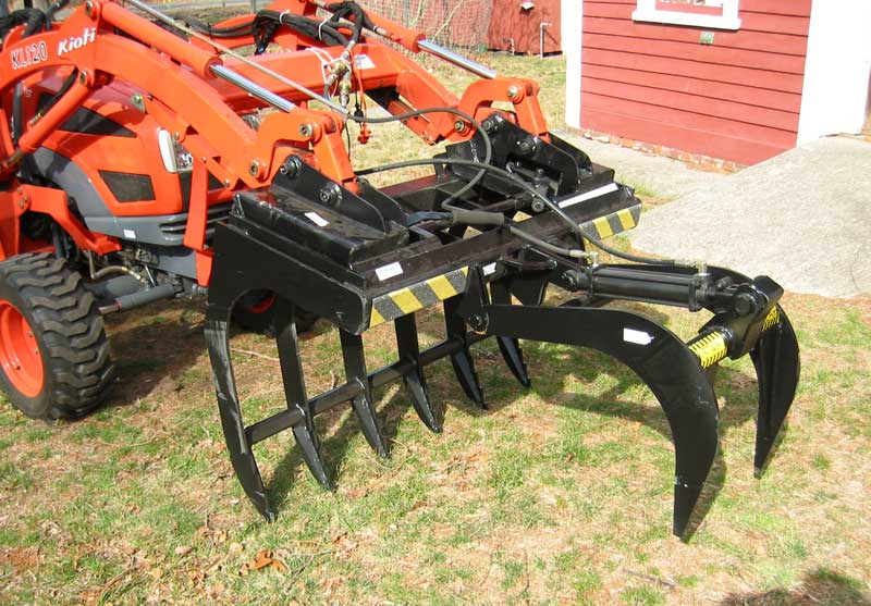

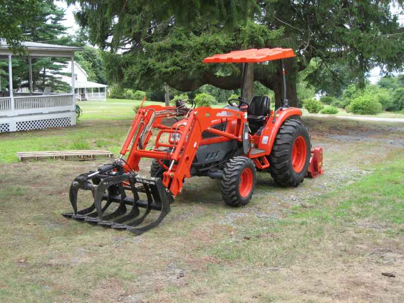

Hey, I agree with that decision.:) No question the best bang for the buck out there is the 48" Millonzi. The 48" grapple will be just fine. I have yet to see a coherent argument on TBN for anything bigger except that some guys insist on having grapples the same size as their buckets. Save the money you'd spend on a 60" grapple and get the 48" then treat yourself to a "free" bonus implement or diverter valve.
I've posted many times that I liked my rear remotes to control the grapple but then I had rear remotes on my CK20 so it was a no brainer. I now have a new tractor that has both rear remotes and the WRLong diverter. I like the diverter too (but am still having trouble getting used to it). I would be happy with either set up. I suspect if you are having them installed by a dealer that the rear remote option might be a little cheaper but not enough to be the deciding factor. More important is whether the rear remote controller for your tractor would be in a place that you could easily (unconsciously like a stick shift transmission) move your hand to from the FEL controller without looking). If not then go for the diverter.
Photos of 48" Millonzi on the CK20 and the DK40se. Works beautifully on both tractors. Not too big for the CK20/KL120 and certainly not overpowered by the 2700lb lift capacity of the DK40se/KL401.
