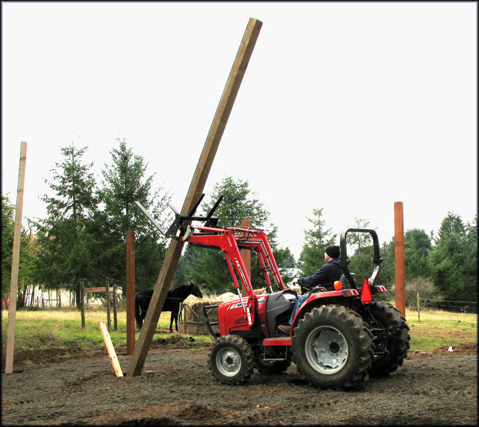

Fourth pic is raising the longer of the posts. I was able to raise the 14 footers by hand fairly easily. I need a little assistance in the form of the Massey 1533 to raise the 22 footers. It went pretty smoothly for having no help that day. I carried the pole to the hole on the forks, set one end over the hole against a 6 foot section of 2x6. I then blocked up the post, drove around to the other end, set it on top of the forks, and walked it in as I raised it. The 2x6 stops it from digging into the opposite side of the hole and allows it to slide down in a controlled manner. I marked the "pivot point" of the post to ensure that I didn't pass it until a significant portion of the post was in the hole.

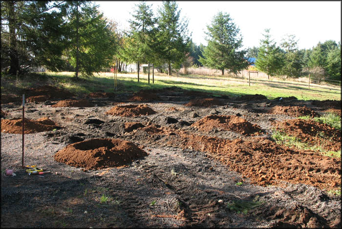

Fifth pic is with all the excess dirt cleaned off the pad and all poles in their holes.
Very interesting you putting those long poles in without any help. I understand the concept until you get to the blocking up part. Which end of the pole did you block up? A little more simplified explanation from that point on for us simple folks woule be appreciated.
I work a lot by myself, and I'm always looking for ways to do things alone without getting hurt. In fact, I will be putting in some heavy 16' cedar posts for a gate entrance. Thanks for any clarification you can provide.
By the way, I don't have pallet forks, only a bucket with toothbar.
Here's a step by step:
1. Carry pole to desired hole.
2. Suspend one end of pole horizontally above hole about 2 feet in the air.
3. I used a 2 foot tall scrap piece of 4x12 to block then end of the pole (the end opposite the hole) about 2-3 feet off the ground.
4. Lower the pole, one end will rest up against the 2x6 placed in the hole, the other end will be supported by the blocking.
5. You can now drive out and re-align the tractor, so that you are facing the end of the post while looking straight ahead at the hole.
6. Pick up pole with the top of your bucket (forks in my case) and lift it a few inches.
7. Remove blocking, so that you are not driving over it as you walk the post in. At this point the pole is up against the 2x6 that's in the hole with the other end supported by your loader in some fashion.
8. I lifted the pole to about 5 feet then started to creep forward. As I crept forward I slowly raised the loader.
9. Eventually you get to a point where the post wants to slide down the 2x6 and right it self....go slow here. A couple of times I had to get off and shift the 2x6 to assist things a bit.
I'd imagine you could use a bucket, might take a little more effort but would be possible. A friend of mine set 26 foot posts in the same fashion with the bucket of his loader. They chained the posts to the bucket to move them into position over the hole, and used two guys to hole the post up, vice blocking it up. They then used the same method I did to walk them in.
Thanks for the detailed explanation. I now fully understand the concept. I will give it a try with my poles.

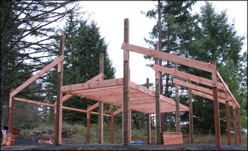

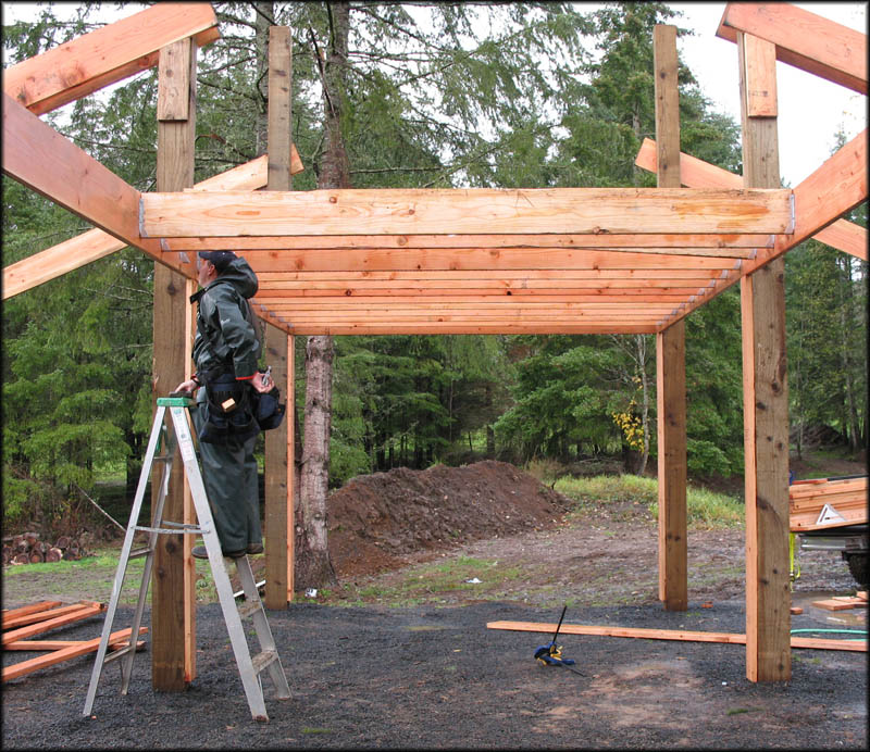

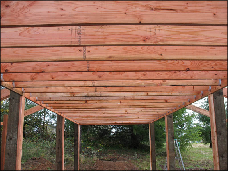

Updated:
Was a long miserable week. Figures, I take it off to work on this and end up working in the rain for most of it. Didn't get nearly as far as I would have liked to. The lean to section rafters are up, the loft is framed in. Still have to go back and drill and bolt everything together, everything right now is just nailed. The loft decking will go on tomorrow, then I can raise the center section rafters, and put up the roof pulins much easier.
1st pic: Pole are all set and braced. We had 40 mph winds the day after I did this. Everything was still level the next morning.
2nd pic: Hanging the loft joists.
3rd pic: Loft joist are done. Now I just have to go back and put in the other 500 or some odd nails in the joist hangers.
4th pic: Overview looking south.
5th pic: Different angle.

   / Want to see yet another pole building? #8
Keep the pictures coming... looks like you will be done soon.
   / Want to see yet another pole building? #9
Looks awessome!!!
I reallly like the second story and how strong you are building it. Looks like it will last forever!!!!
Thanks for the updates and I'm looking forward to more of them.
Eddie
   / Want to see yet another pole building? #10
Very nice, please keep the pictures coming. Thanks
