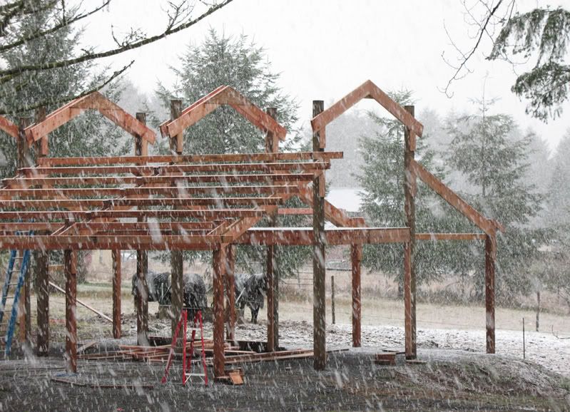

Slow progress over the past week or so, it's dark by 4:15 pm here and lots going on with the holidays.
The center rafters went up today in the middle of a snowstorm. I started nailing on the blocks for the overhang, so I know where to set my first row of roof purlins, they have to be dead on as I plan to sheet the roof in OSB, prior to putting the metal down. I didn't get very far before the snow collecting on the rafters made it difficult to look up or see my pencil marks. You can see one roof purlin nailed up on the far side.
So, with no idea how much snow was going to fall and it being a wet heavy snow, I figured it prudent to sink the rest of the nails in the joist hangers supporting the loft floor. 16 nails per hanger...ugh.
First picture is looking SW, about halfway between the house and the barn.

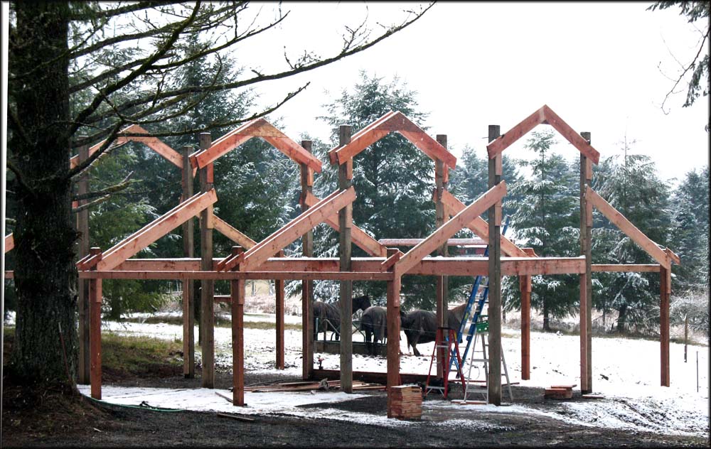

Second picture is looking S, taken during a break in the snow, we're up to 4" at this point tonight and the loft hasn't come down yet....haha. Notice the scrap lumber hand warmer fire to the left of the pic...it was a lifesaver today.

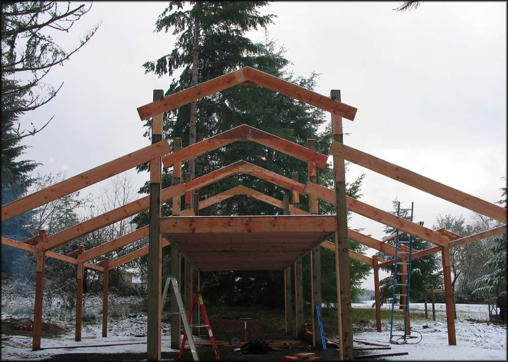

I saw a request for an update in another thread so figured I'd get at least one picture of where I'm at up.
Things have slowed way down. Awful winter weather and lack of daylight have really slowed me down. Of course I knew that was going to happen, still frustrating.
The purlins are up on one side, this picture was taken christmas day. I've since put up the blocking between the purlins on the end rafter and hung the fascia boards on that section of the roof. I've got the center purlins up on the other lower roof section.
I hesitate to start putting roofing on until I know I have a few days to get it done. We get some pretty nasty windstorms up here, and the last thing I want is the partially installed roofing being torn off. Once the lower roof is done, I'll progress to the upper sections, working off of the completed lower roof.
I'll continue to update as things gradually progress.
