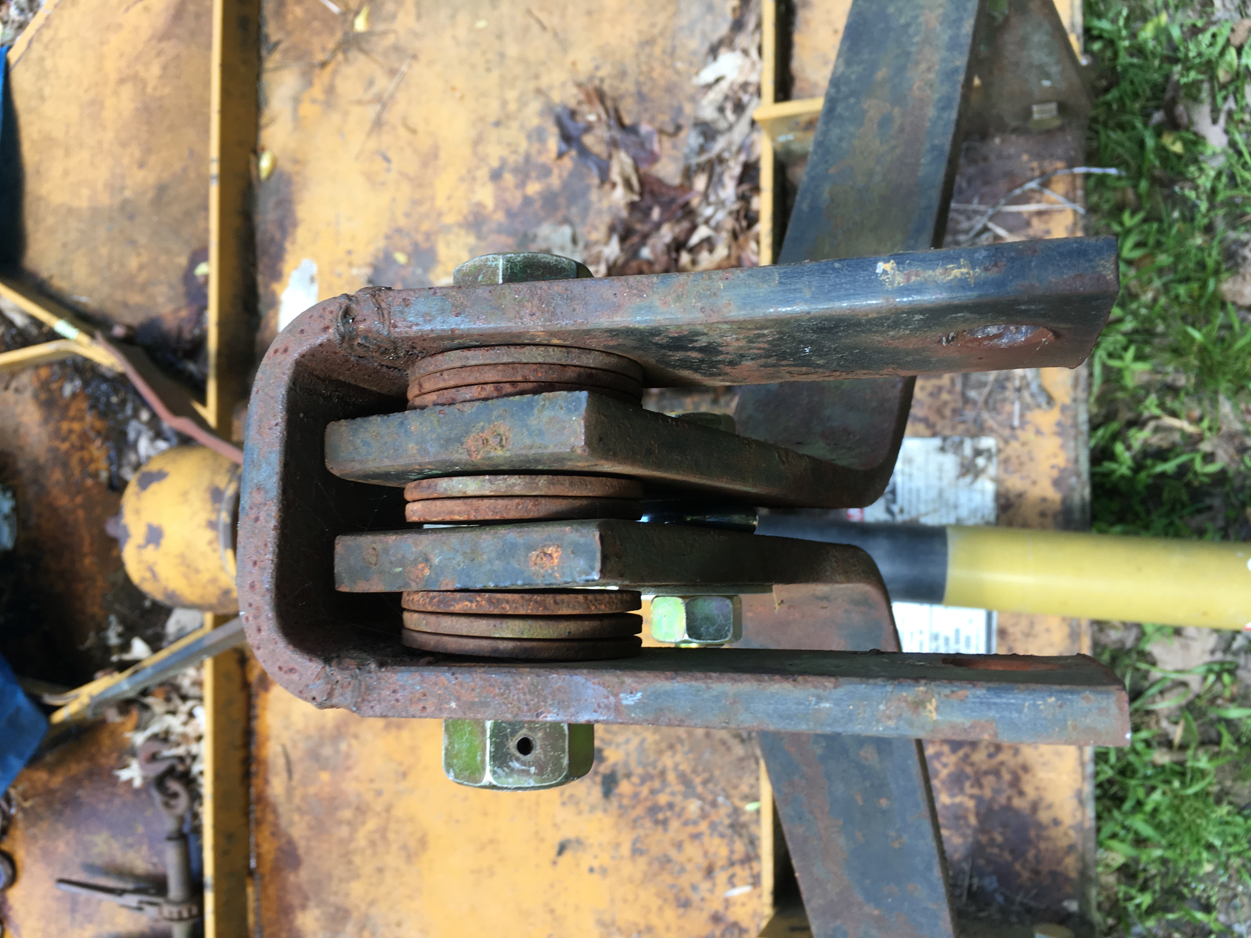

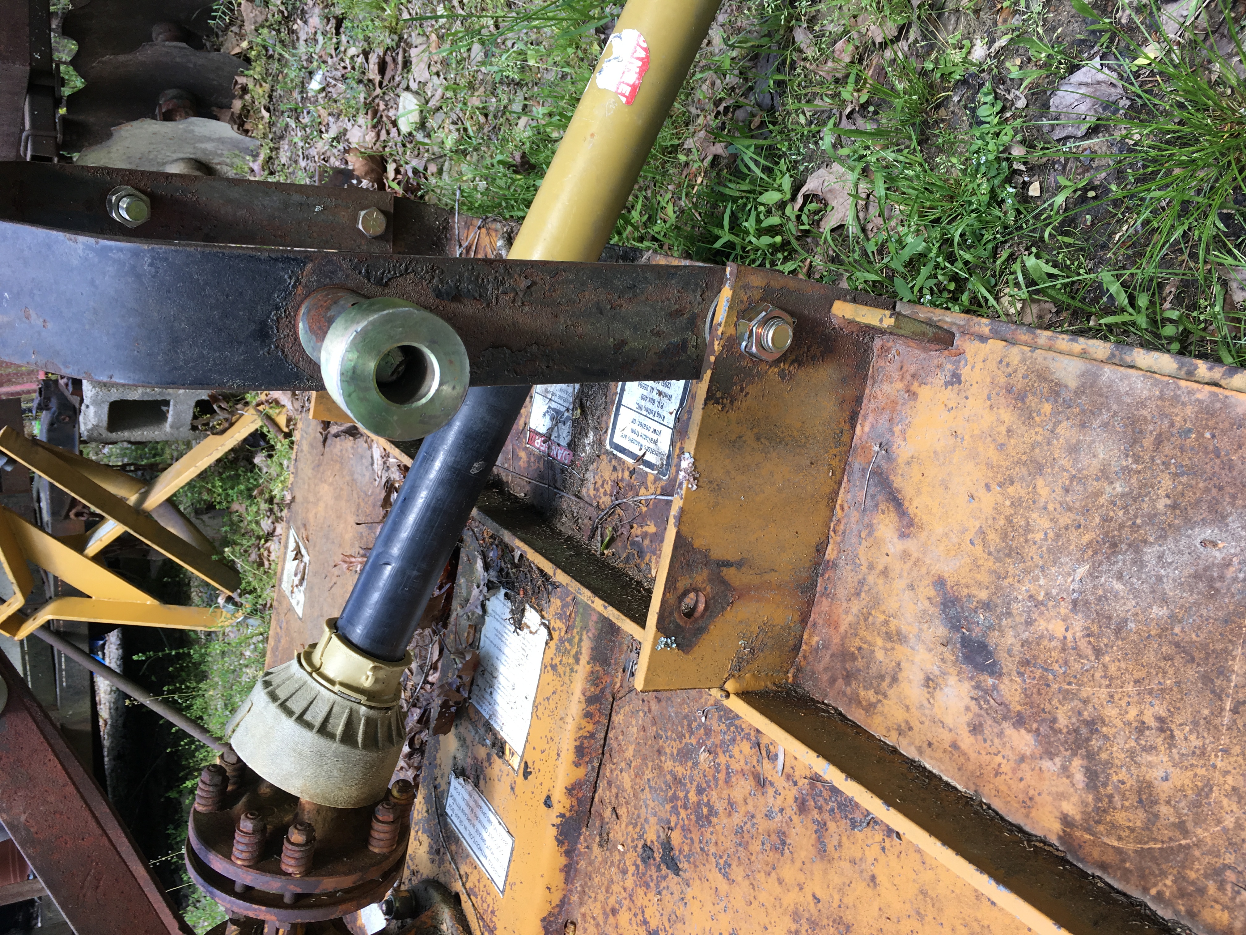

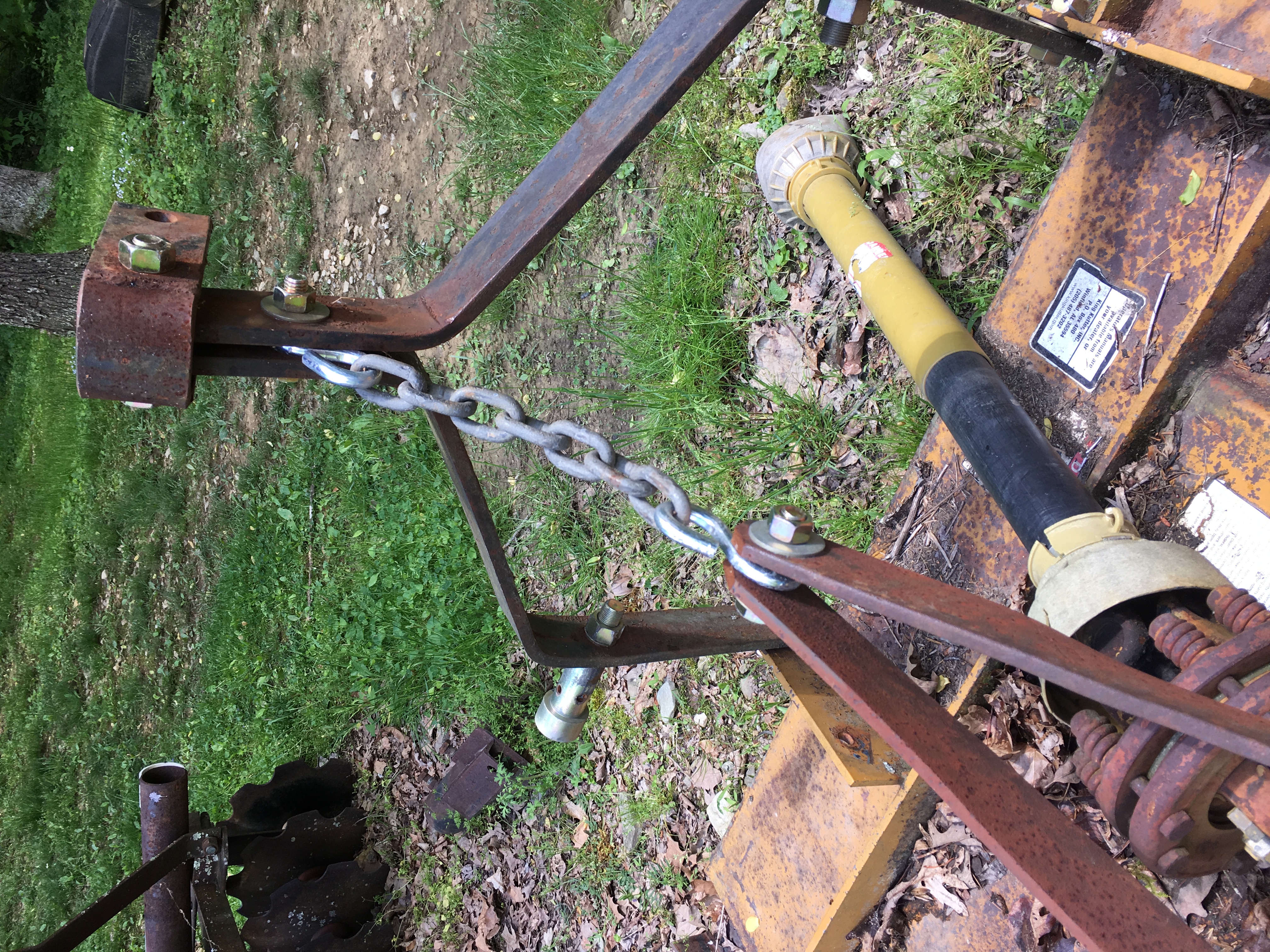

43445924-0087-4AA4-B07F-20E6187BE80B.jpegF031DD6A-D9F6-40D7-B818-84B3B2CDD7E0.jpeg4BFF2FB8-2644-4DE4-A0C5-37A9B049CA5E.jpegI have an old 5 ft KingCutter that I did a quickie mod on it to fit my HF quick hitch. I removed the three point braces and remounted the three point on the inside to get my clearance. Removed the upper link attachment to close up the arms and remounted it with washers for spacers. I then cut the back lift braces so that they would hit the gearbox and not the slipclutch and attached a chain.
The three point pivots now and with the chain gives me the flex I need. Its not pretty but I used what I had on hand one day. Yes I hope to tidy it up a bit and repaint it all in the future.

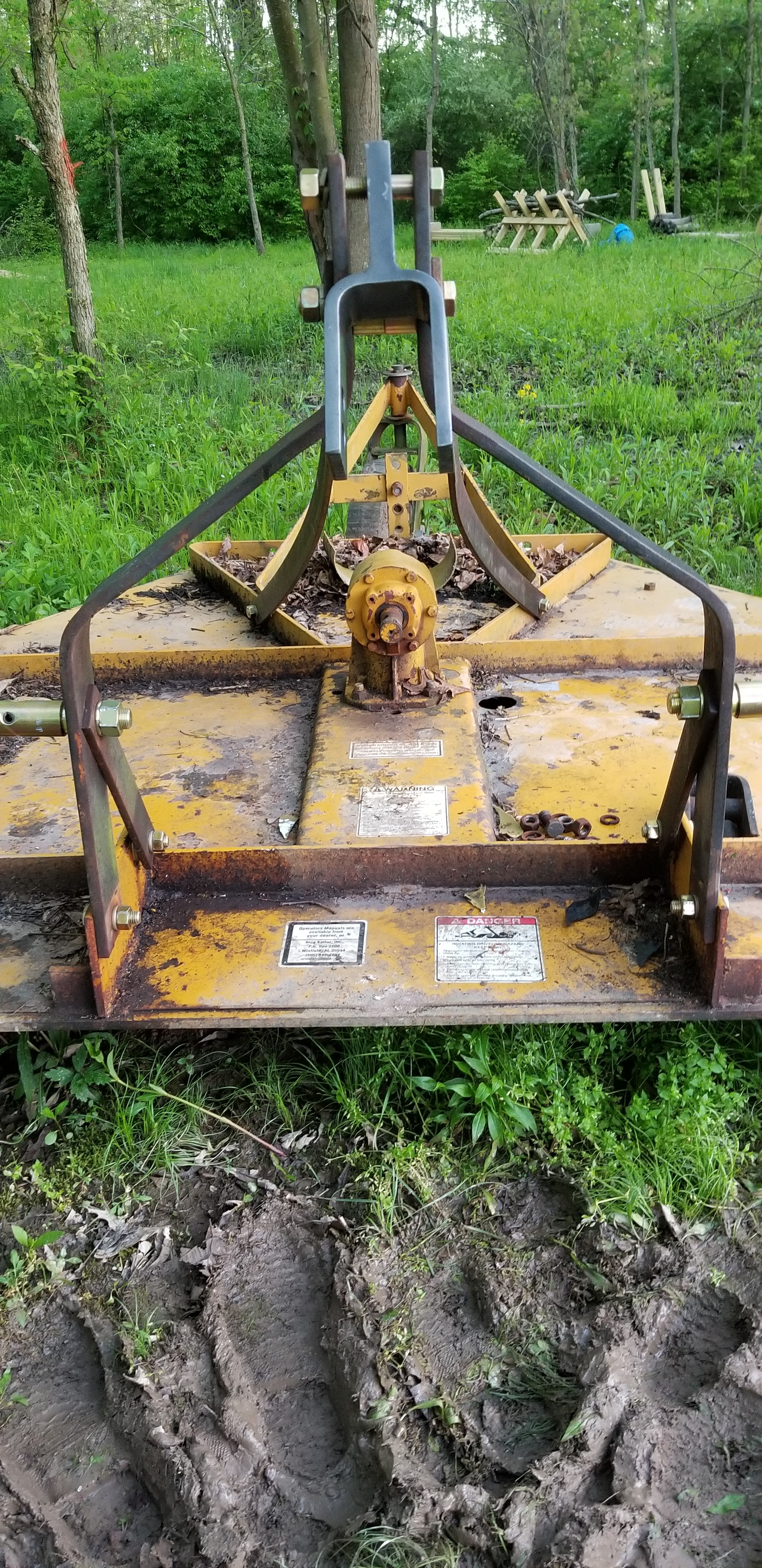

I ended doing almost the same thing Alan W. did with his. The Flex Hitch conversion was getting expensive so I just started taking things off and trying stuff. Mine is a 6ft so things lined up a little differently. i was able to use the back braces without cutting. The top link spacing was the only thing. I used some bushings to get the right spacing then added a top like adapter yoke. Thanks for all the input. Still need to get the bushing installed on the top link otherwise it looks good to go. I hadn't thought about the floating top link until it was mentioned so once I can get out of the mud I'll give it a try. 20190506_202300.jpg
