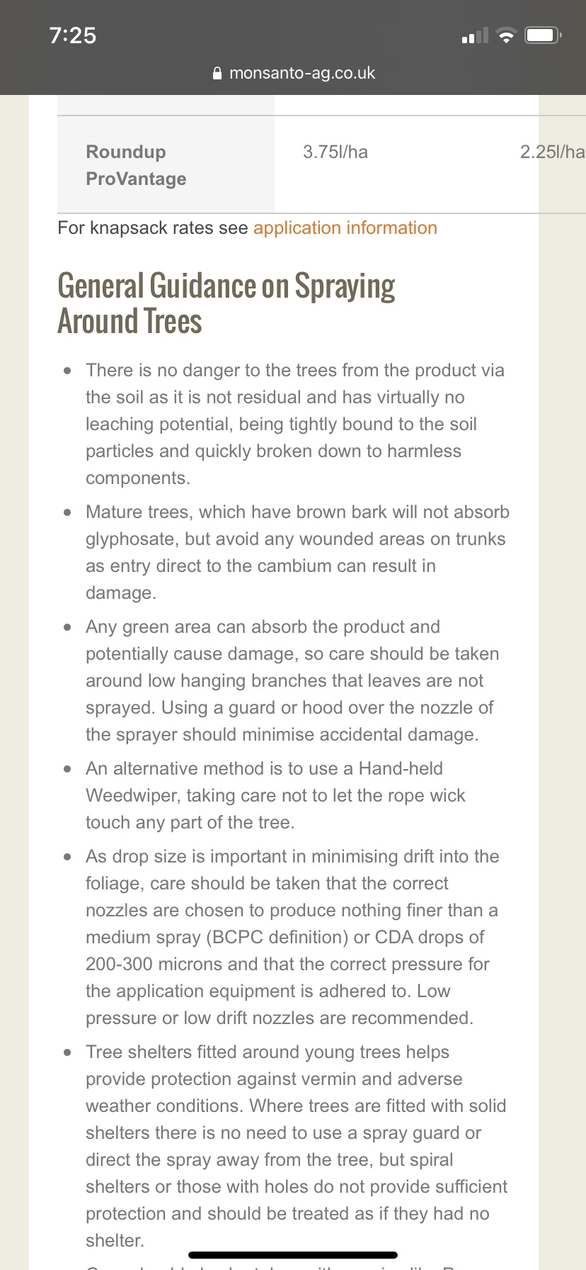

You should be fine. But - below is what the manufacturer says.
Good luck.
