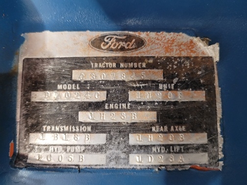

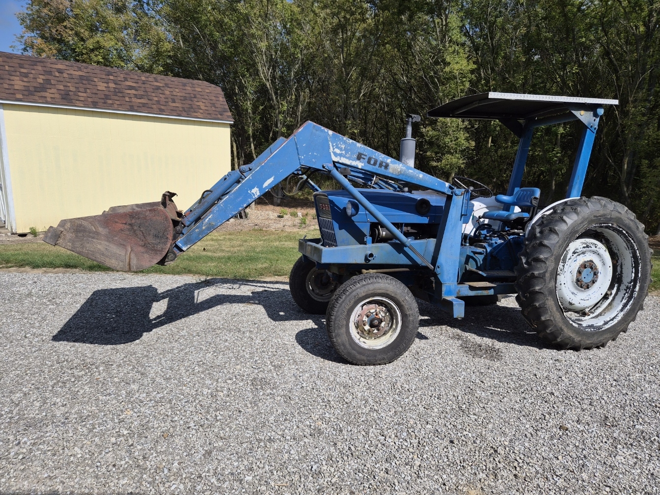

Sounds like you have a "row crop" style tractor. Utility style tractors have 26"/28" rear tires. You would also have to change front axle outer extensions and spindles. Would help if you could get us the model number off of the ID plate under the hood. A side picture of your tractor would be good also.
   / Want to change tire size on 71 Ford 4100 tractor
i will get you a tractor picture tomorrow since is dark here now. I believe this was initially owned by the road commission because it does have orange paint under the blue.
Attached is the tag inside the hood
Thanks
Carl

Interesting tire choice for a road department tractor. What size are your fronts now? The 16.9x24 is 51" diameter/25" radius, while the 12.4x38s are 60" diameter/30" radius approximately so you are dropping 5" lower. There are smaller tire/wheel combinations that might get you what you want.
Another possibility may be 16.9x30 or 18.4x26 R3 which would be very close in size to what you have now.
