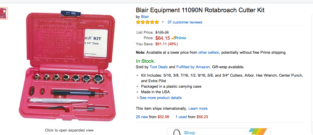

Rotobroaches are awesome in their own right!!

I always figured those were more expensive than that. That is not a bad price, with no shipping delivered to your door by the brown truck.
Yeah that is a heck of a price! They are usually quite a bit more but I think these are cheaper as they are limited in their depth capability. I think I'm going to order them if still available.
