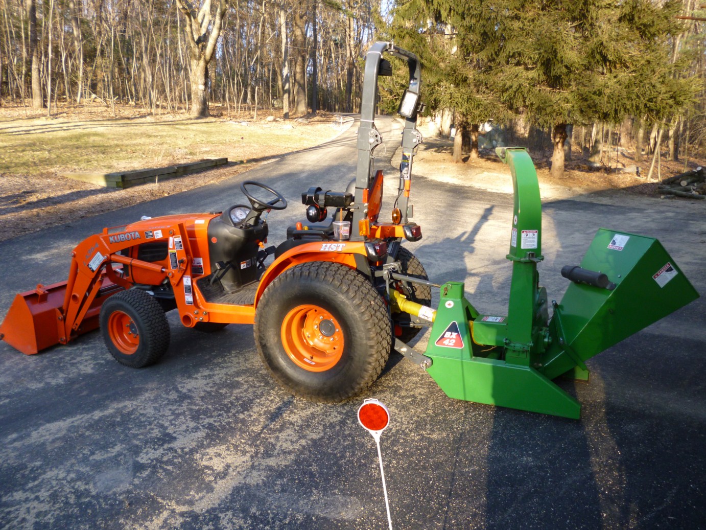

I chipped for about 5 hours today and again was amazed at what I could put through. I did a bunch of green white pine branches (with needles) and had no trouble at all. They were a mix of big branches that broke off in storms and smaller stuff, all with needles and relatively green. There were some small pines mixed in from an area I cleared out as well.
I think the most interesting thing from today was handling vines. I have a huge number of these nasty vines with big thorns. They're green and grow to a width of maybe a pencil or a little bigger and grab onto everything. They're a nightmare because if you cut them they just dry out and stay there with the thorns seeming to get even sharper and woodier. Today they were all over the stuff I was trying to clear out and I decided to try an experiment. I gathered a huge pile and then shoved them into the chipper hopper in a ball and then just kept shoving more until there was a big mass in the hoper and they were getting pushed into the blades. I then used a stick to push the whole mass in to the blades and surprisingly it ground up everything with no clogs. I did that procedure for maybe 1 - 2 hours and got rid of a huge number of these vines. I won't use the chips for anything though, they're full of inch long vine pieces with thorns, but at least this way they'll decompose. I'm not sure if it worked because its very cold, or maybe the vines aren't woody enough to cause a clog, but I was pleasantly surprised and now have a solution to my vine issue.
Here's a pic of the chipper & tractor after i was done. You can see a piece of dead vine on the PTO safety cover. I'm surprised I haven't damaged a tire with these dang things, they'll poke right through a shoe.
