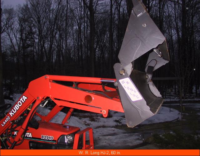

I finally got my camera. A while back I told some folks I would post a few photos of the HJ-2 60" bucket installed on my Kubota B2910. I'll send them up in successive posts with attachments. Let me know if you want to see any other views.

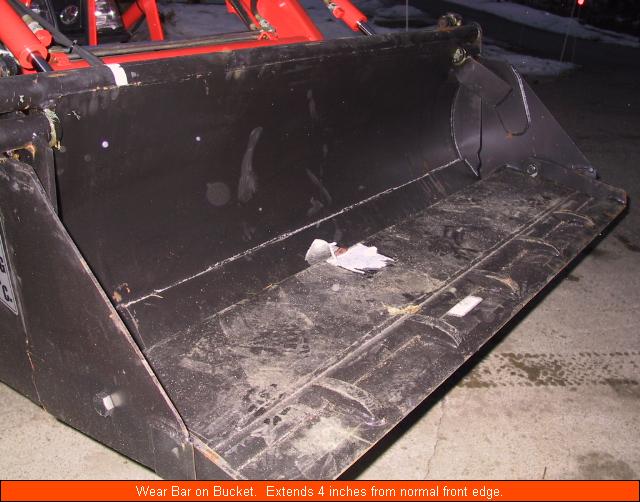

   / W.R. Long 4in1 Photos
#2
Bucket showing wear bar attached.

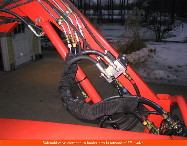

Shows the mounting of the solenoid valve. Later I plan to shorten the hoses a bit to tidy things up. Had to loop them as they are the original hoses that went to the steel cylinder tubes.

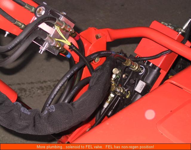

More plumbing. When I ordered the tractor in January I had them install a "3 position bucket dump" valve...special order from Kubota. It adds a second non-regenerative bucket dump position. The regen dump position is still maintained when the fel handle is in the extreme right position. In other words there are two dump positions right of "center" handle position. First is non-regen, second is regen (fast--but no power) dump. There is a detent that is pretty easy to feel between the two.

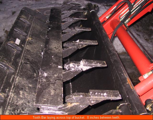

Last photo unless more requests (I err on the side of boring some, I am sure...but Long does not have a web site and I shure wished I could have seen a few more photos before I bought mine)
This is a shot of the optionl tooth bar. It may be confusing because it is laying across the top of the bucket. The steel bar the teeth are welded to 1/2" thick. As is the bottom side of the optional wear bar mounted on the front shown here.
