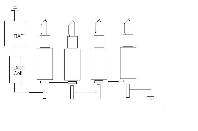

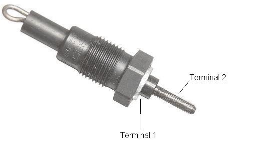

If you were asking me to post a picture here's what I'm talking about. Sorry for the crude drawing, don't have time for artwork these days.

I see, one terminal is a stud and the other is a collar. Now we need to know the current and voltage drop for one plug, that will lead us to the wire gauge and dropping resister.:p

I just refreshed my electricity knowledge and in fact, we must add resistance when in series. So voltage is reduce bye each glow plug and the resistor of the "indicator" in the dash panel.
It seems that all I have to do is to put a switch in the circuit of the indicator and the 4 glow plugs that are in series and it will be fine. I am looking for explanation on Internet that will describe the plug Champion 155 but nothing for now.

series resistance is addative.. however.. if they have 1 terminal.. you have a bunch of parallel plugs it would look like.. thus you would need one series resistor which then feeds all the parallel plugs

The way you have to wire a Bosch loop plug is a little tricky if you don't have the proper info close at hand.
These plugs do not ground through the body, there are two terminal at the top of the plug. There is a ceramic insulator that keeps the two terminal isolated, if you missing those insulators that's the first problem you need to correct.

if there really is 2 terminals at the top then that answers alot of questions. had this been posted up front it would have been much easier to figure out.

OK let's keep it simple. To find current us a multimeter set to ohm's and read the resistance. The plug says it's a 0.9V. So ohm's law says I(current)= V(voltage)/R(resistance). Current though a series circuit is constant. To find the resistor needed would be 12V - 3.6V(4 plugs) = 8.4V and plug it into ohm's law again this time finding resistance for the resistor (R=E/I). The last thing is to find the power in watts that the resistor will need to handle. This is just another variation of ohm's law (P=E*I). To solve this would be P=8.4V*I(current found earlier). Size the resistor the next size larger to be safe. Now to keep it simple for the indicator. 12V to switch, switch to 12V light and resistor, light to ground and resistor to plugs.
