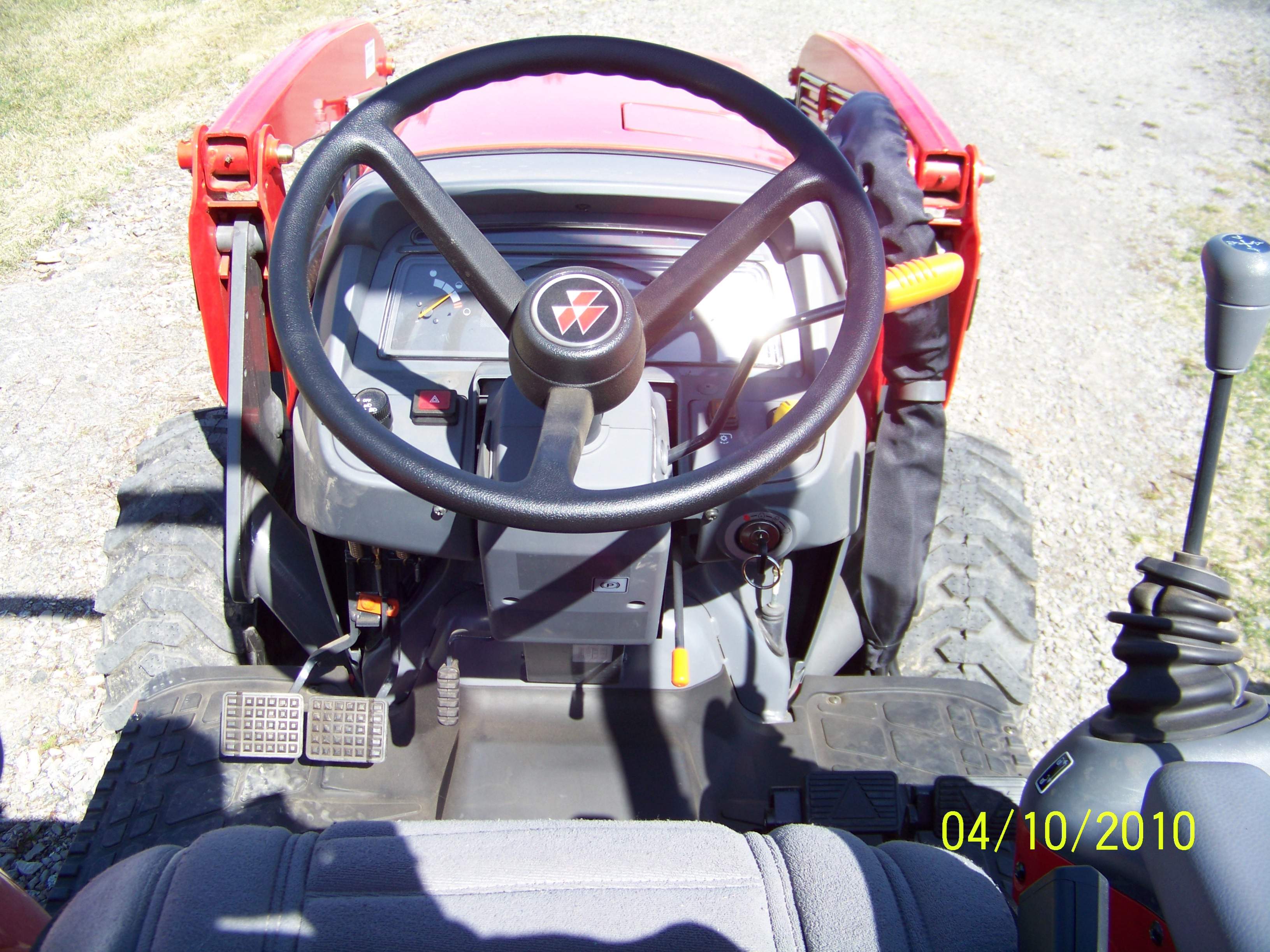

Hi! On Massey Ferguson 1600 serie( mine is a 1643) there is a special button that we can depress if we want a **gentle ** start of the pto. We depress it and then put the electro magnetic pto start ( and cancel it after it is running for a few seconds). It gives a softer ( more progressive) start to my mower but it still gives a shock . I do not know if that can be put on yours?? But the best way is to start it at the lowest iddle possible ( in my case) . Good luck. Roger.
I put a photo, it is the amber yellow square button left of the yellow pto switch on the right side of the steering.

Well, ya put your steering wheel right over that magic switch! I figured someone would have some sort of 'soft start' switch or setup by now. Good info....bad pic. (of the button) ;)
   / Violent start of rotary cutter #27
As you said , good info bad pics... nothing is perfect:laughing:
I had taken that photo a few month ago and used it today. But at least you got the idea :D. Have a nice day sir .
