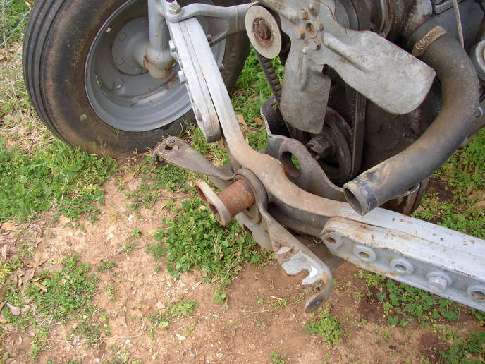

Old 2WD Tractor but 4 WDs are basically the same. Front axle pivots on a horizontal axis around that big pivot pin in the middle. Makes it a tricycle.
(Until the axle hits a pivot stop)

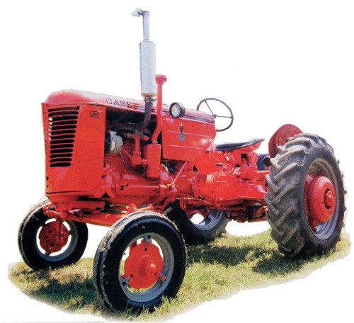

Going with old iron again since it is easier to find pictures. The front axle would pivot on a horizontal axis on these old Case tractors until the axle hit that inverted V you see in the picture.

Your statement is not true until the front axle is fully oscillated. Before that point it is irrelevent where the front tires are.
What a wide axle provides over a tricycle is to catch you when full oscillation is reached. A safety net of sorts.
With a tricycle, once the roll over starts there is no return.
