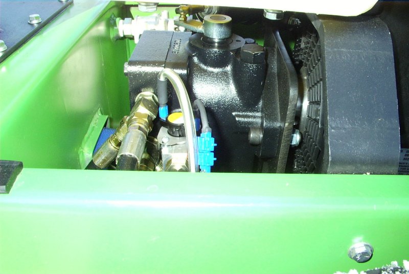

If you look at this picture, you can see a silver crank arm on the top of my variable volume pump. There is a cable connected to the end of the crank that goes all the way up to my treadle pedal.

If you look at yours, there is no crank arm. There is a box on top of the front of the pump with hoses connected to it. Those go to the valve that your treadle pedals are connected to.

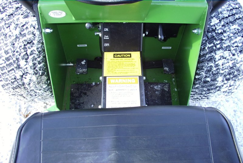

Also, I mentioned that the treadle is slightly offset from center. The longer arm is on your right foot and the shorter is on you left foot. At least that's the way mine is. You can see it in this picture. I think it is so that there is more control and range of motion in the forward direction, which you use more often and to leave a place for your left toes to sit when you are mowing. Why keep them angled up on the pedal for mile after mile of lawn?
