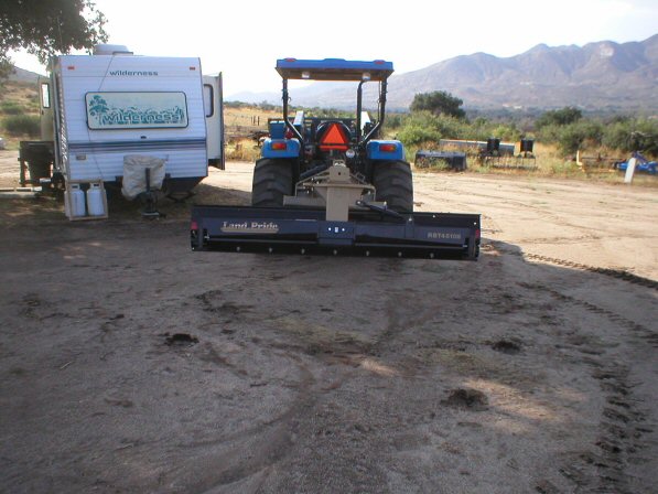

If you get a Land Pride, you will need either a RBT40 series for 65-100hp and that is available in 84", 96" and 108" widths. Or an RBT45 series for 70-125hp, in 96" & 108" widths. Their big blade is the RBT55120, 120" wide.
Land Pride also has these blades rated for gross weight with the 40 series rated for 9500lbs and the 45 & 55 series rated at 15,000lb.
Another very good rear blade is Bison. I actually wanted one of those, but the wait was what I thought was to long so I went with a Land Pride RBT45108. They are not cheap, but I'm not going to bend this one up either.:D
