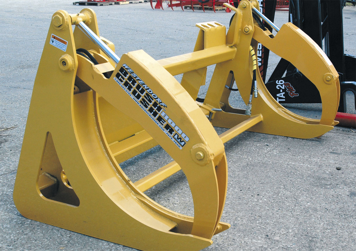

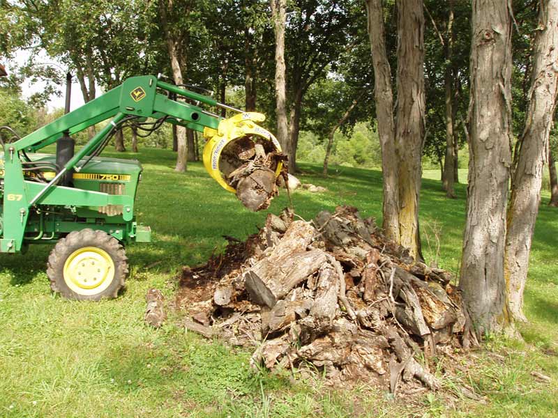

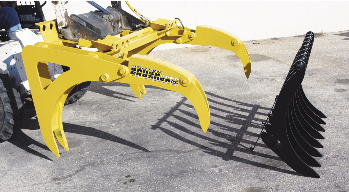

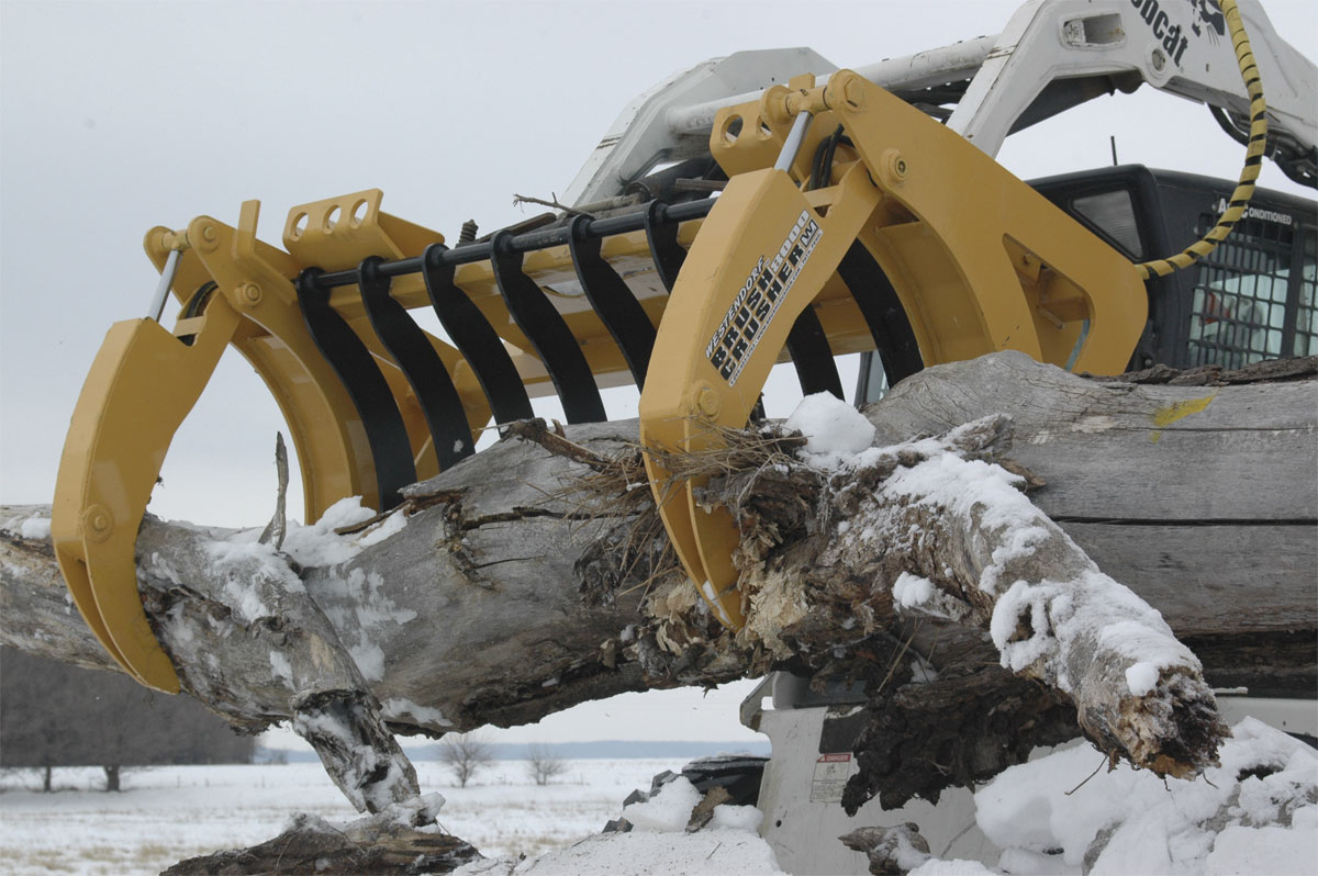

Each unit has it's function and it's application. If someone wants an inexpensive grapple without having to modify their tractor, the mechanical units are ideal at around $800-$900. We restored the hydraulic option for those that are equipped for hydraulic attachments such as larger loaders and skid steer users and they want to pay more... as you stated adding hydraulics adds cost. My estimate of $2000 said "up to"... that is if you add new 3-spool valve manifold and joystick plumbed into the tractor. If you want to rig the hydraulics you can do it for less. I will agree with your last statement of flexibility, and if you are using the units for land clearing and stumping, we'd consider you a heavy user and we'd recommended you go with the heavy duty hydraulic 8000 unit that retains the tilt feature and is built with heavy steel tubing supports. If you are using the grapple in the spring and fall to clean out a grove, pick up a few downed trees or clean up the yard, the mechanical units are a great cost saving alternative.

Seems like there are a lot of products out there with two separate grapple arms, each with their own cylinder. Does your patent cover something in addition to that? Got a patent # handy?
John
   / Very Dissapointed with MIllonzi Grapple #58
Not only that, getting the two jaws to work independently seems more like a function of hooking the two cylinders up in parallel. I mounted dual bucket grapples in parallel and they work like that. I'm pretty sure there's no patent for parallel hook up, is there?

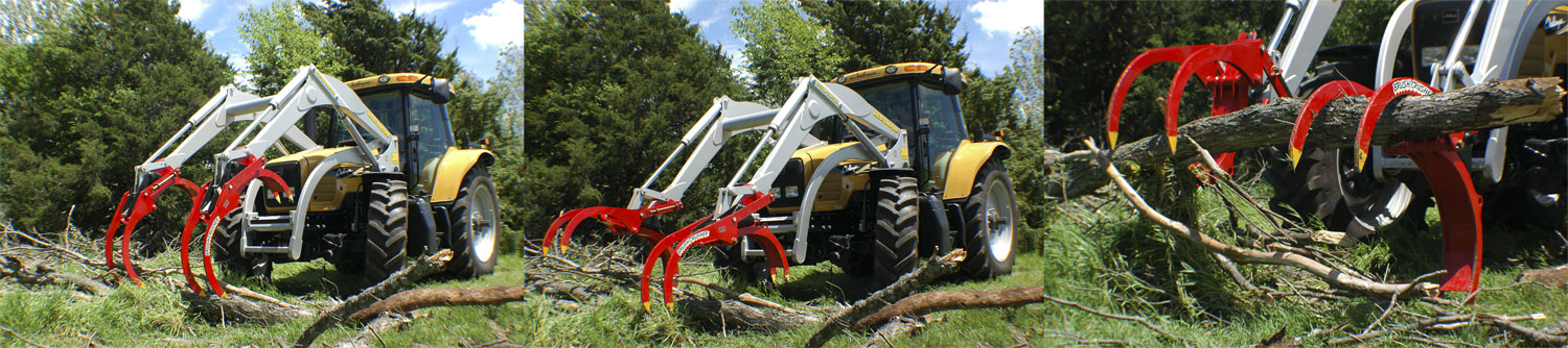

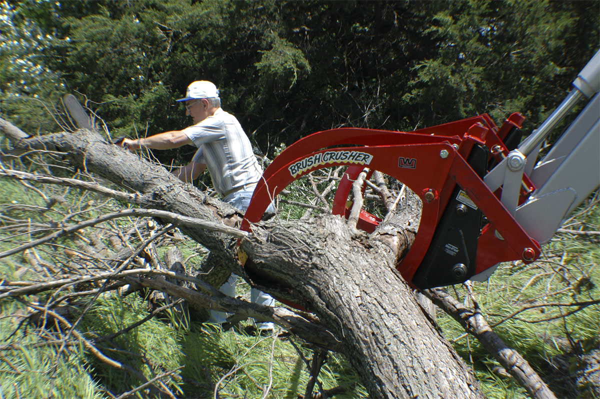

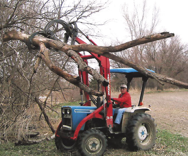

It has to do with the bottom part of the unit not just the top teeth. All other units on the market are mounted on buckets or a rigid set of lower teeth. Ours does not utilize a bucket so both the lower and upper teeth are independent of each side. I should have stated that more clearly. When you can get rid of the bucket you increase your visibility, you also move the load closer to the tractor for more lifting power and capacity. Our hydraulic models have rigid bottoms, but the mechanical units feature two independenly operated claws in the patent. The patent should be on US patent site under Westendorf. It is hard to envision, so I tried to illustrate with a series of photos. First a loader approaching the load, photo of what happens once the teeth encounter resistance as they close, and finally how the teeth have pivoted on the mechanical linkage unevenly around the load for a secure hold. The teeth alternate when they close based on the path of least resistance to conform around the uneven load. A couple of other photos also showing solid grasp on very uneven loads as trees are not very often even.
The other unclear item is in a previous post you say BOTH the mechanical and hydraulic units have the patented independent lower jaws. Still, that is a mechanical difference from the usual setups and I can see why you would encourage someone to reserve judgement before trying it.
Off hand, the traditional independent arms will handle a tapered load and the rigid lower structure will level up the load as you close the jaws if one side of the load is higher than the other. I can visualize your patented feature maintaining the cocked load position after closing and then you have to carry the load higher to keep it from dragging?
