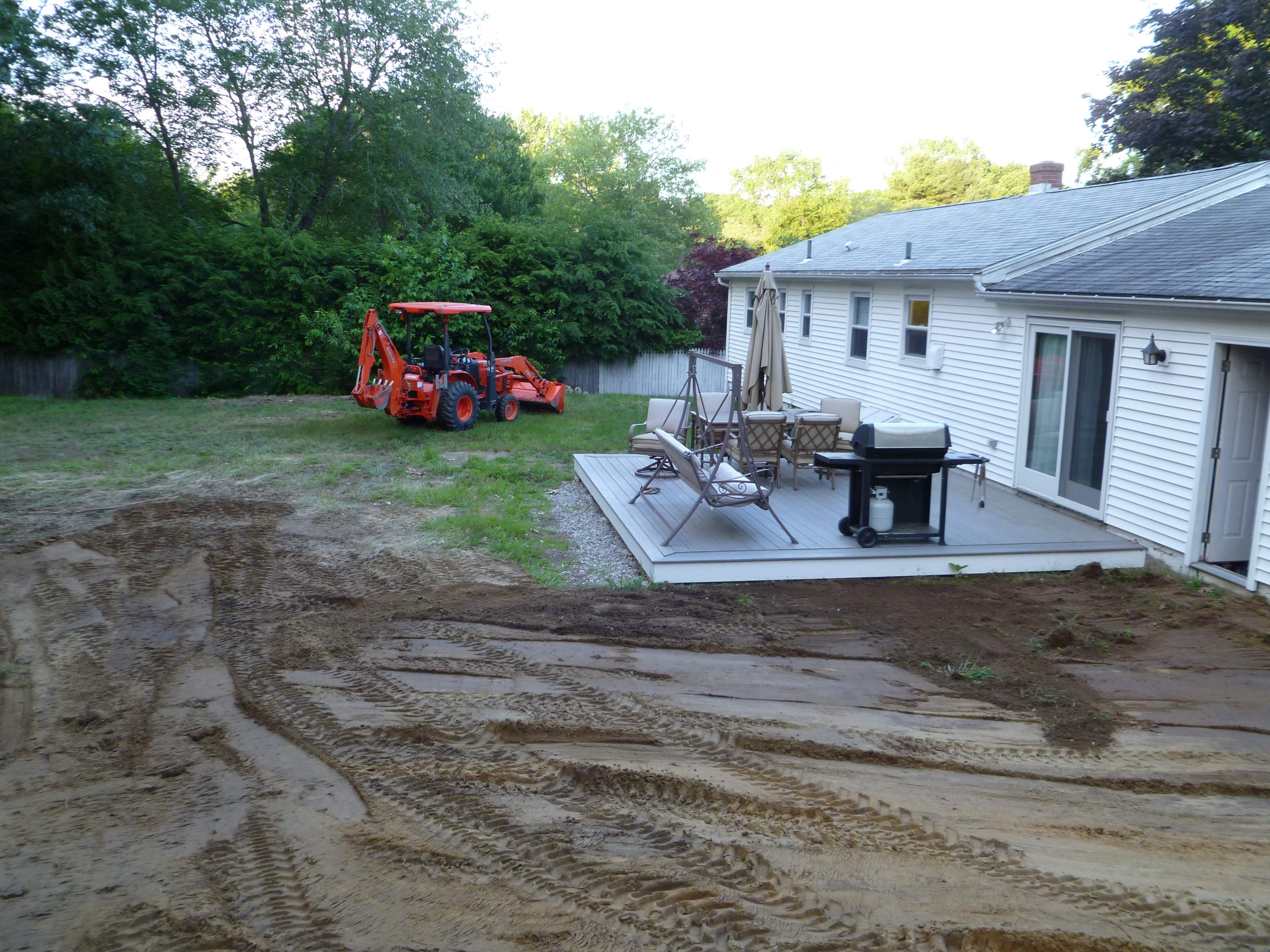

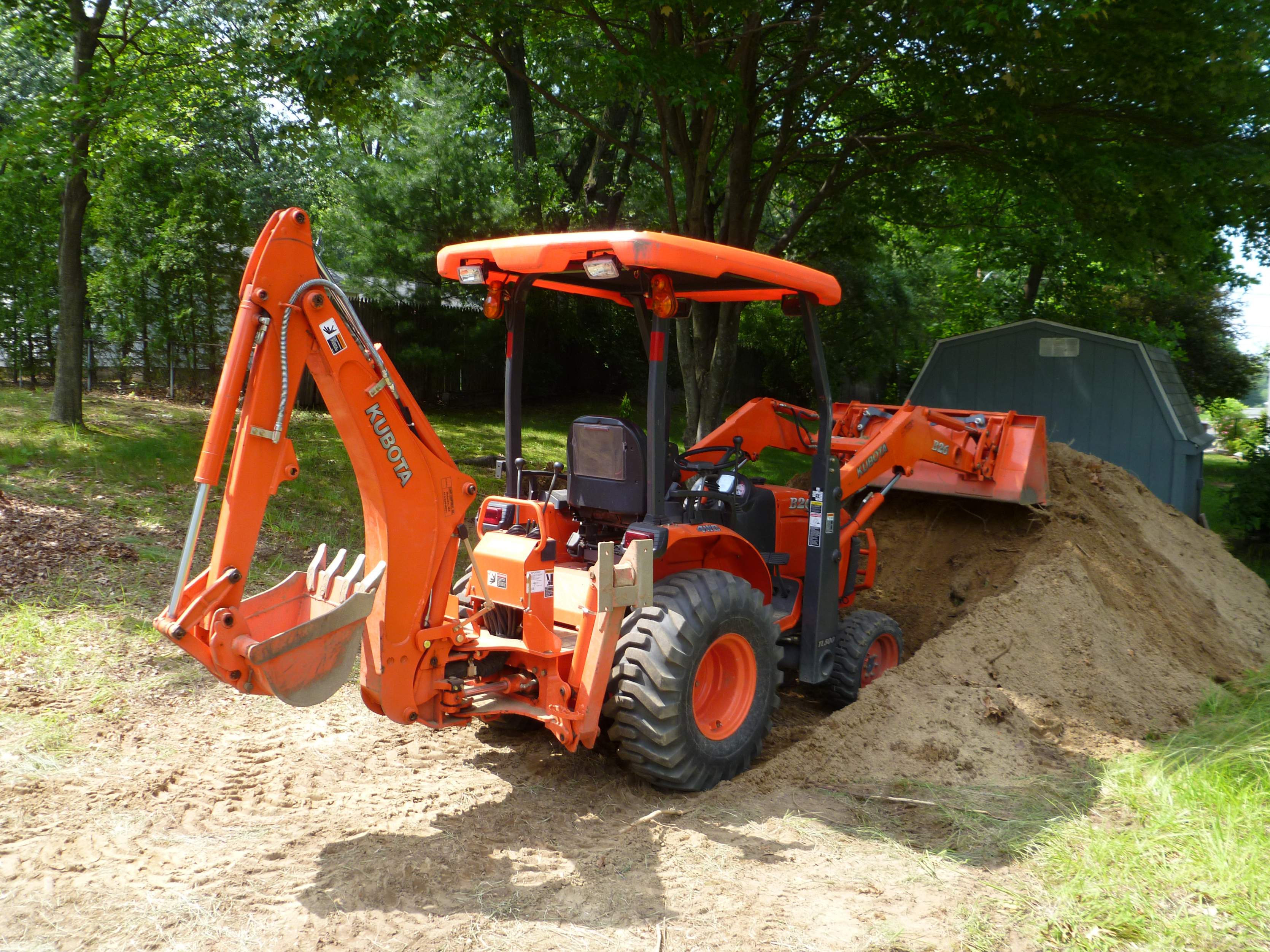

   / Very close to purchasing a B2920 TLB!
Here is the B26 that I rented in the midst of my backyard excavation / leveling project... Thanks to my neighbors who let me move 30 yards of fill to their heavily wooded backyards.
Oh, don't pay attention to my roof (it's ugly hahahaha), I just had it re-roofed last spring and it looks a million times better. Glad I didn't have to lug 24 squares of shingles up there as I was considering doing it myself with some help, glad I didn't!
