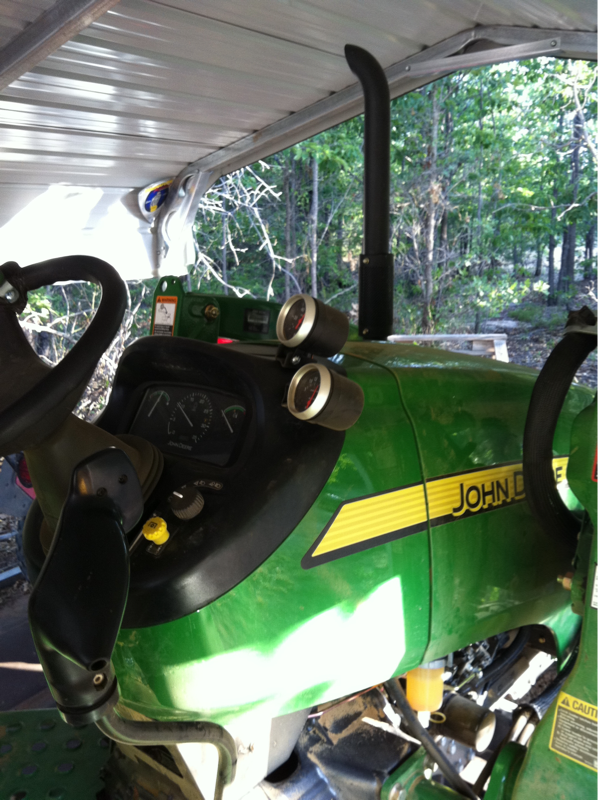

You are going to like it you don't get near the exhaust in your face
Heres a pic you can kind see the stack

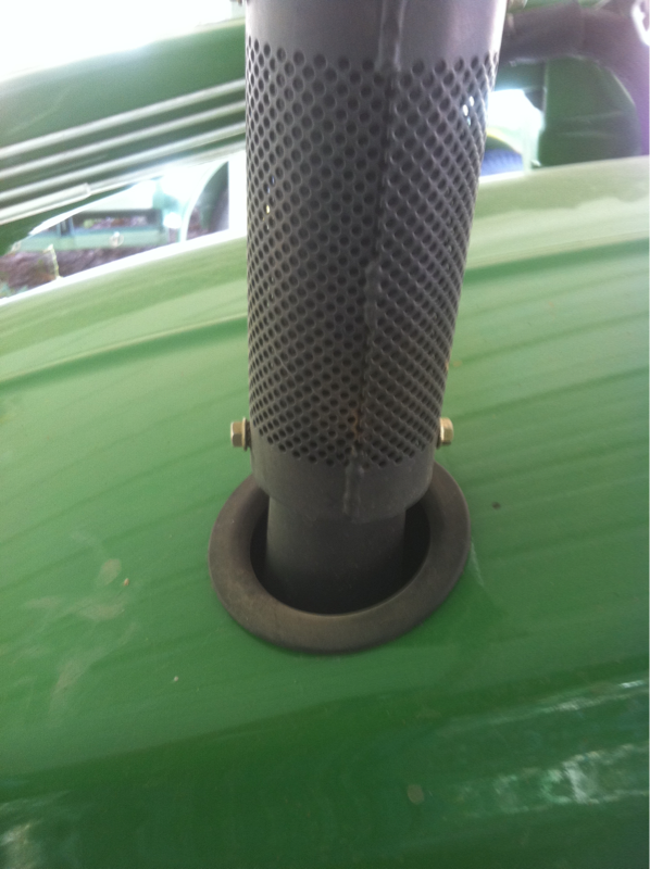

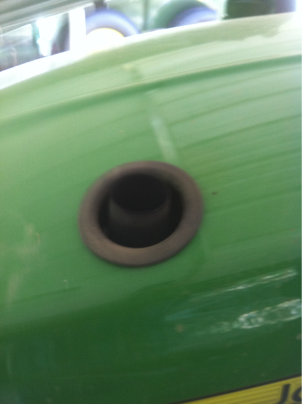

The hole size I drilled was 3 1/2
Hope this helps
Have fun
