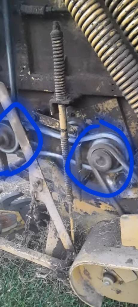

vermeer 505 super i baler problem that i can't figure out.

Did you change the bearings on the opposite side at the same time?

I have to say that I've never let my bailer or any of my hay tools get as filthy as the one pictured. As dirty as any of my hay tools ever get.
   / vermeer 505 super i baler problem that i can't figure out. #15
We took all belts off and got them the correct length. Never had a new bales. Always run these 2000 dollar jobs. I think your roller that moves is not moving smoothly and giving the appearance of slack. Also make sure tensioner has full range of motion and a smooth action. Check for stretched springs and broke springs. I think the belt roller that moves is hanging in its movement. It keeps constant tension. It should follow that bale as it gets made. Hay bales aren't round while being made.

chains appear too loose. take a link out. oiling i use motor oil, burnt motor oil , hydraulic fluid used hydraulic fluid and gear oil, can chain lube and chainsaw oil. i actually think chainsaw oil last longest. i use which ever ones convenient. but what really matters is chain quality . better chain lasts longer and makes sprockets last longer.
