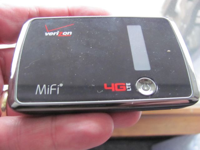

Your iPad has wifi and sends out requests looking for wifi networks pretty much anytime you do anything with it. Your hot spot sits there listening for devices that are asking if wifi is available. Kind of like, "Hey, are your there?" and "Yep, I'm here."
You're old enough to remember TVs that took a while to warm up, right? So they made them with warming circuits that kept the tubes warm, so when you hit the power switch, they seemed to come on instantly. They were never really turned off all the way.
Well, hot spots take a while to boot up, get their IP adresses set up, etc... just like booting up a computer. That would annoy people. They don't want to wait for 30 seconds for the thing to boot up, let alone walk over and turn it on. So, the vendor programs the hot spot to never really turn off. It kind of sleeps, but is sitting there waiting for any network activity and pops to "awake" ASAP.
Any computer, laptop, phone, tablet, smart TV, etc... with wifi enabled will wake it up. And you can pretty much guarantee that the vendor wants it awake as often as possible to run up your data usage any time that is possible.
As you have discovered, the only way to make it stop is to unplug it when not in use.

mifi.jpgmy mifi runs on a battery. unplugging it just keeps it from charging. Mine also can be turned off by holding the button down a few seconds. Mine shows green light for 4G service, Purple light for 3G service, yellow light if off and charging, no light if off and not connected to power.
