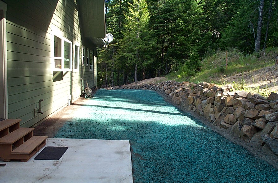

I don't know what your building codes would call for but as far as venting out the side here is a pic of the vents for my propane FAU which is in my basement. You can run them up to the floor joist space then out of the siding. The vents are to the right of the steps in the picture.

joeyD-thanks for the pic- that's exactly what I'd like to do with my water heater flue. Does your propane furnace have a power draft or a combustion blower?
I'm leaning toward getting the heater and venting the flue through the basement wall using a draft inducer like this one (about $80) Tjernlund Blower, Draft Inducer DJ-3 | Zoro.com
