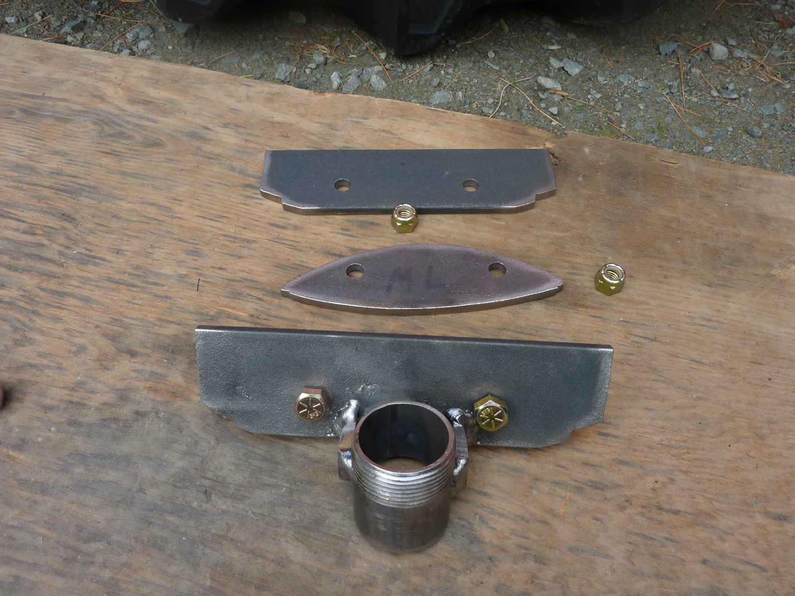

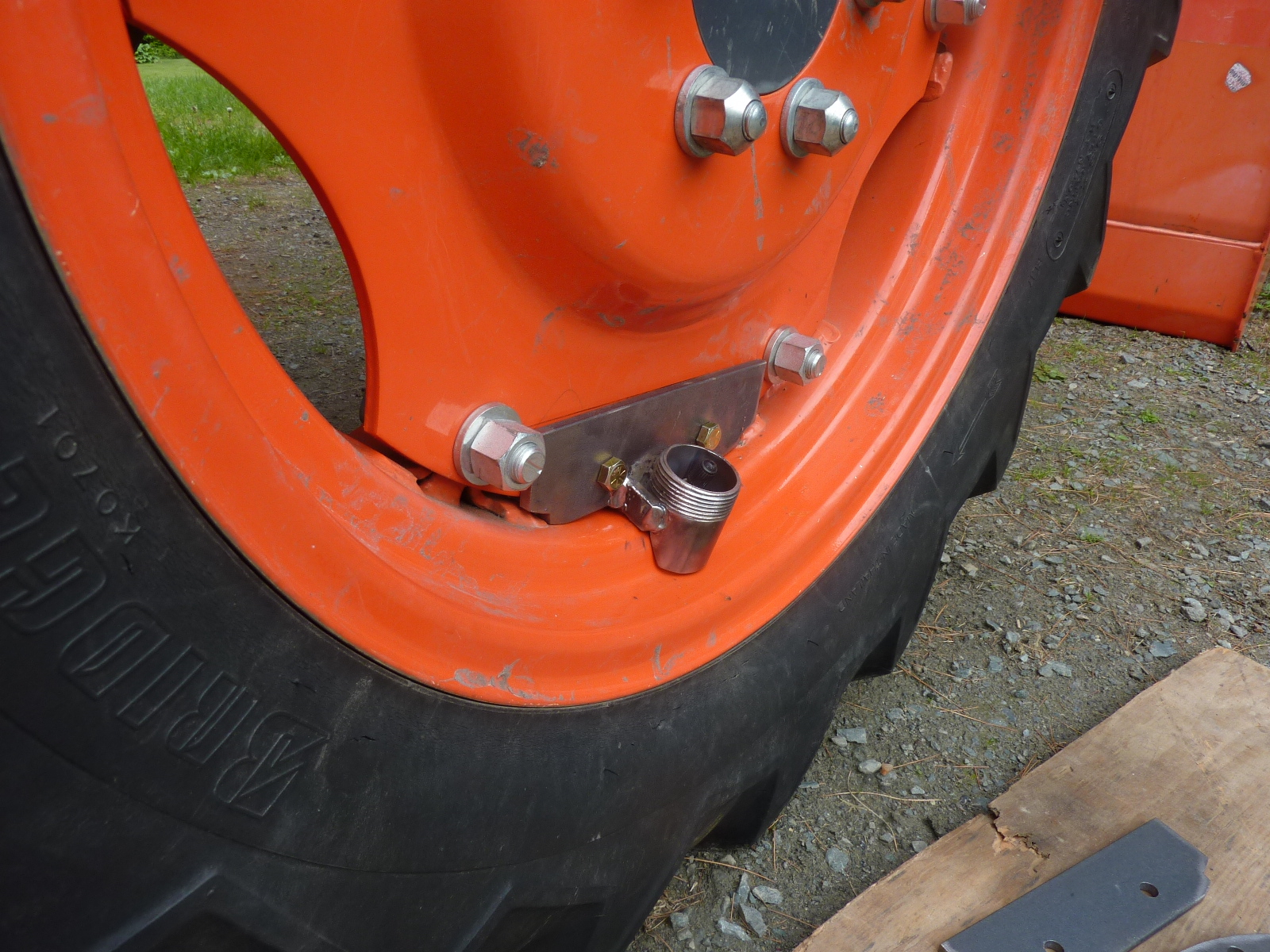

Think I would have ended angle with a sleeve so valve stem was still accessible with out having to remove anything....
Dale
Dale,
I'm not sure what you mean about a sleeve, or how it would fasten, and be removable. I can have any one of these off in a few minutes including getting the wrench.
I had to limp out of the woods on 3 wheels twice before I was smart enough to put on some valve stem protection. I didn't want to dismount the tire to weld either so I made a sandwich clamp affair thru one of those moon cut-outs with a piece of pipe welded to it. Those you made should work good for you M convert.
gg
This concept is what I was trying to suggest way back in post #4....

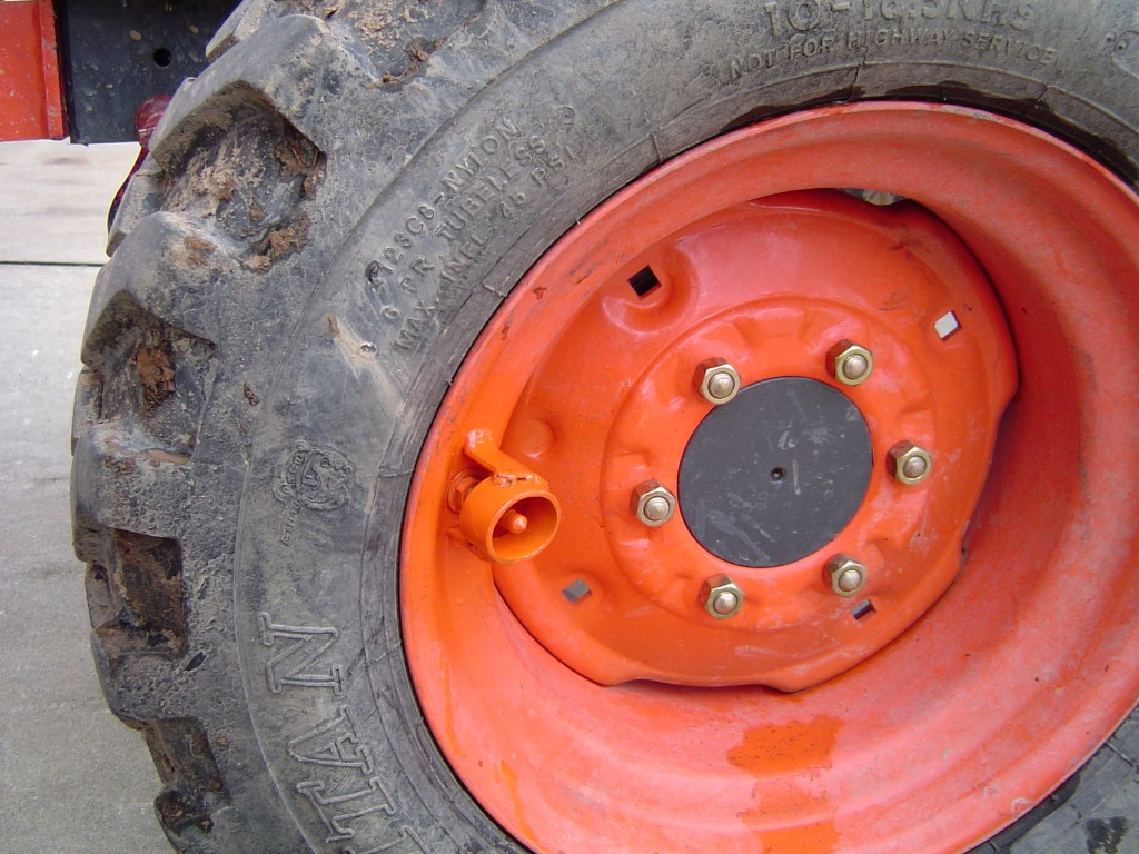

There are very low profile valve stems available that are only about 3/4" tall and all metal. Not bullit bullet proof but certainly many times better than a rubber pull through. But unlike your unique solution, you'll need to at least break the bead to install it from the inside. At that point you may as well weld a cup on the wheel.
Very clever solutions you and Gordon have 👍
