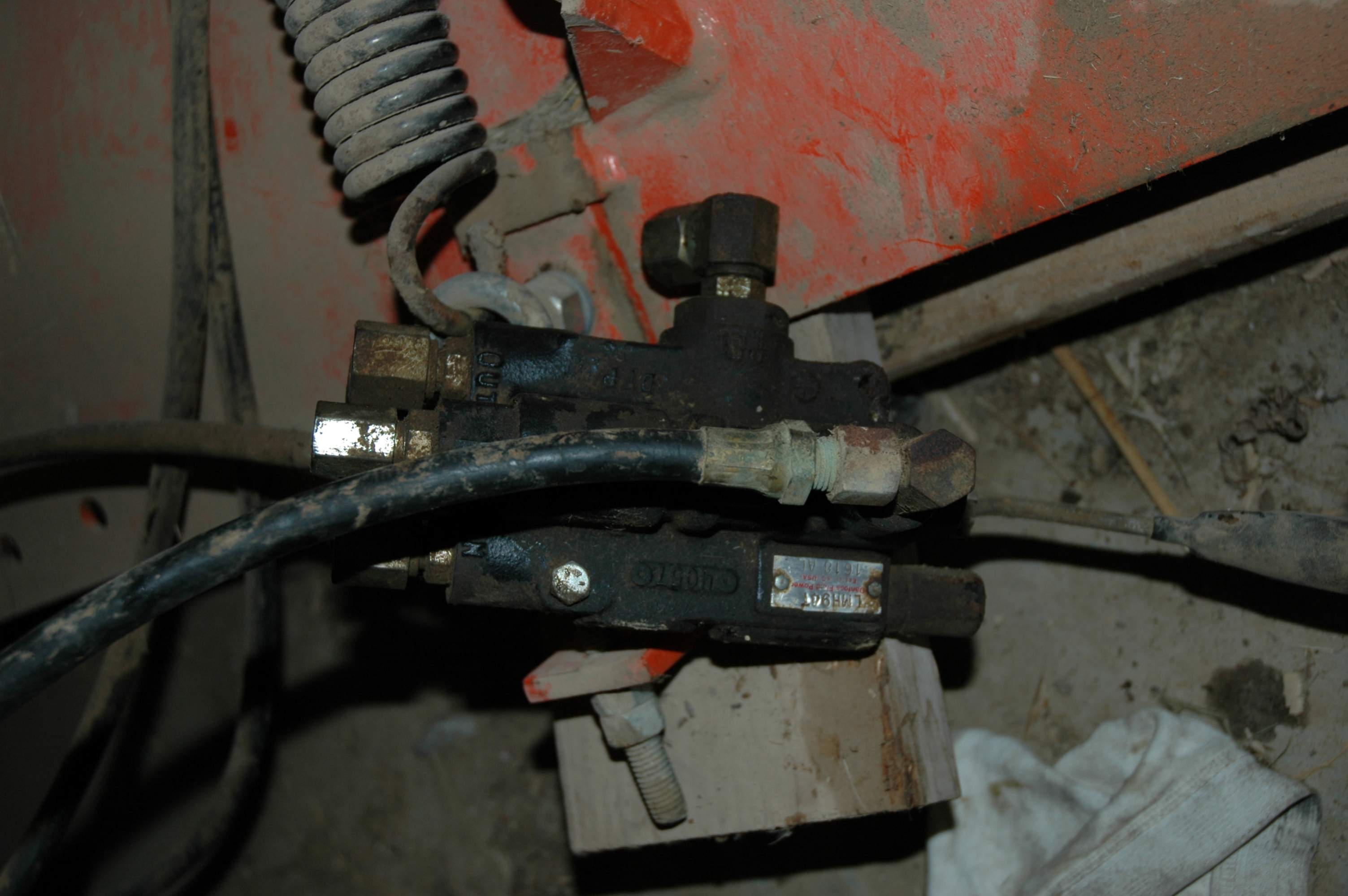

Boys what I see when looking at his picture. I see a hose going to the in port, a PB hose and BP plug, a QC on the A port, a QC on the out port and I don't see a hose to the tank or a B port where it should be. I looked at the plow and it has a double acting Cyl. I think the valve is for a single acting Cyl. and Tom is trying to run a double acting Cyl.

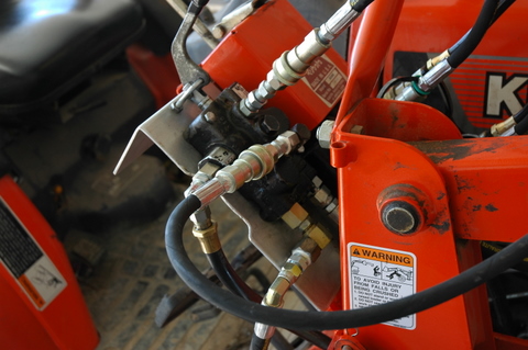

LeeJohn. The picture you are looking at is just for identification of the valve. The IN of the blade valve is not visible in this picture. In this particular picture I have the cylinder blade hooked to my loader bucket spool. I was testing the cylinder trying to isolate the problem. The problem lies at the B port. Right now I suspect that B port is open to the TANK in neutral. Sauer-Danfoss says they can't identify the configuration based on the identifying markings, contact the dealer. I've emailed my local Kubota dealer today so hopefully I'll have the valve configuration soon.
Anyway the valve is plumbed like this.
PB of loader valve to IN of blade valve
OUT of blade valve "tee-ed" to OUT of loader valve to TANK
PB of blade valve to IN of tractor hydraulics
Quick connects on the blade valve work ports which are quick connected to hoses of the blade cylinder.
Here's a picture of the valve in the state I bought it. If you look closely you can see the IN port. If you zoom in you can see the letter N above the IN port and the word OUT above the OUT port.
Just as I suspected, SD OEM'ed it for Kubota, and they cannot/will not provide specs...Husco does the same thing.
I wish you luck getting any info on it...
BUT-What info could they provide that would be beneficial at this point other than to satisfy your curiosity? It is not working for what you need...
