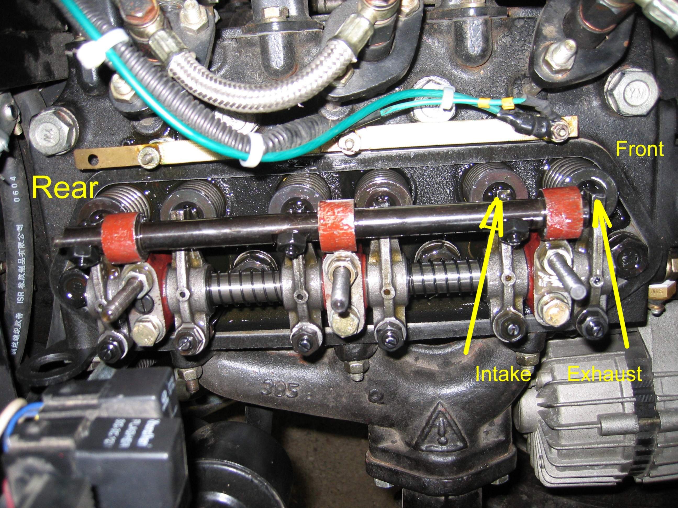

Thanks for the clarification. My engine is a 2007 Y385, which looks the same as yours in the photos. The valves from front to rear are:
Exhaust - intake , exhaust - intake , exhaust - intake .
I know there have been some confusing posts in the past about the valve order , and it's probably not a big issue since the adjusments are very close. ( Some of mine were out by .4 mm)

Yeah, your engine looks just like mine. You can see it's really hard to tell to which valve the fuel injector goes and which valve goes to the exhaust manifold. On my big 4 cylinder 55hp Kama, it was easy to see. But you can bet I'm gonna check it that way when I do another valve lash adjustment on it. It's almost got 600 hours on it now.
About the confusion, I learned for sure that when rotating the engine the exhaust valve ALWAYS starts to close just before the intake valve starts to open. So that's the end of the exhaust stroke and beginning of the intake stroke. That is THE sure fire way to determine which valve is which. Continuing the rotation from that point is the intake stroke lasting 180 degrees and the compression stroke follows with another 180 degrees. So when the engine has been rotated 360 degrees that's TDC on the compression stroke. The engine rotation can be checked by turning it over with the starter motor or from the fins on the radiator fan. The fan should be sucking air through the radiator when the engine is running.
BTW, I noticed your compression relief also opens the intake valves. That has been confusing as well.

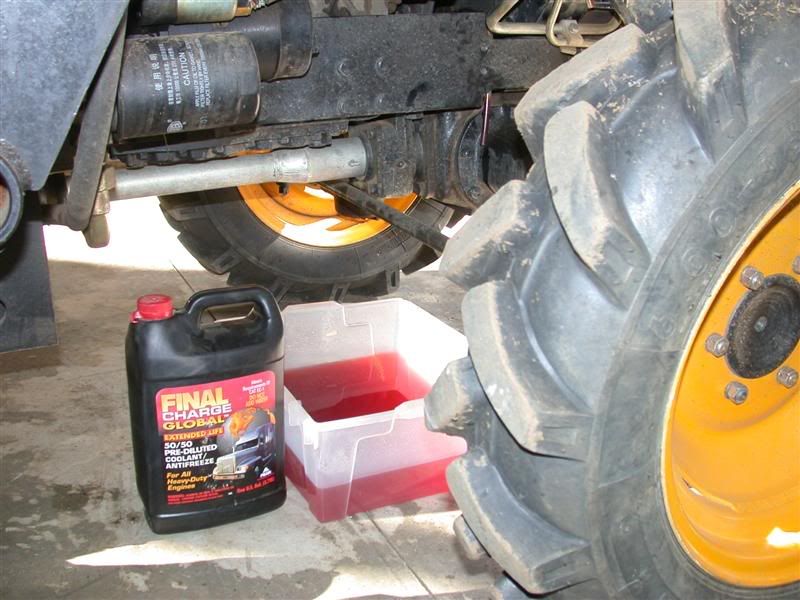

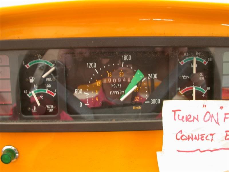

When I set it before, it was TDC of the exhaust stroke, so I corrected it today. I checked them before I adjusted them and found there was way more lash then what I thought. That's why it clacked so loudly, I'm sure. But dang, those Chinese engines just run and are obviously not too picky, lol. But I got it all re-adjusted and it now runs very quietly like it did before, and I can still get over the green area to 2400 rpm with throttle wide open.

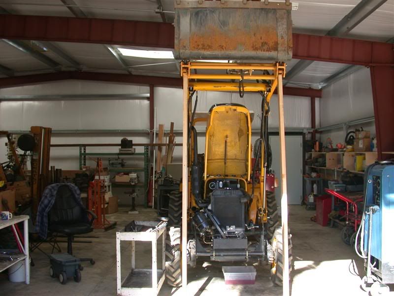

Oh, and this time I propped up the FEL all the way.
It was much easier getting in and out of there like that. Over all, including draining the radiator and removing it all again, it took me about an hour and a half this time from start to finish since I didn't have to take off the rocker arm shaft or torque the head this time.
Here are a couple photos of the loader way up, draining the radiator and the engine reved up to 2400 rpm again.
Rob-
