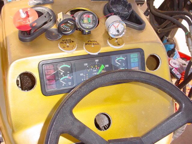

UPDATE: !! Important correction !!
I received a very polite PM from rayh. Here's what he said:
Very good job on showing valve setting. I noticed a little mistake that would give you the wrong valve clearance. When you set your engine up to TDC. You watched the valve change from exhaust to intake. The engine is on exhaust stroke and should be rotated 360 degres to bring it up on compression stroke. Watch for the mark again on pulley, but the valves will not being moving. This is the correct place to start your setting procedure. The rest of your explanation is right on track.
Thanks for catching that Ray!
This means a couple of changes from what I said earlier.
On this QC395Tengine, as you rotate the crankshaft in the clockwise direction (looking from the front of the tractor to the rear) you will see the valves work. There is a point during the rotation where one valve closes and the other one just starts to open. It is the EXHAUST valve that is closing (finishing the exhaust stroke). The valve just starting to open is then the INTAKE valve. At this point the "O" marking on the crankshaft pulley lines up with the pointer.
1) But you have to rotate the crankshaft another 360 degrees to the same "O" mark on the pulley to be at TDC of the COMPRESSION stroke. The valves will not be moving as you rotate the crank shaft to this "O". This was not explained in the manual and stupid me, I missed it ... sorry.
So do that and set your valve lash at that point. Then proceed in the same fashion to do the other cylinders rotating 240 degrees clockwise for #3 next and another 240 degrees for #2 after that. There are marks on the crankshaft pulley that will line up when the crankshaft is turned 240 degrees each time.
2) This also means the valve I thought was intake is really the exhaust valve. The first valve nearest the radiator on cylinder #1 is the EXHAUST valve and the one next to it is the INTAKE valve. The exhaust valve always exhausts and starts to close just prior to the intake valve opening.
3) Additionally, that also means that the compression relief opens the INTAKE valves and not the exhaust valves like I thought. You can see in the photos above which set of valves the compression relief operates. They are the 2nd set of valves for each cylinder which are the intake valves.
I sincerely apologize for my mistake and appreciate rayh giving me the opportunity to let me correct this procedure rather than flaming me. Even though Loretta's tractor ran great in the manner I adjusted the valves per my first post, I will re-do the adjustment this week when we get back to 3R. I'm pretty sure if it ran with little or zero valve lash before, being adjusted with a little more valve lash hasn't hurt it. I'll post the results of it when done.
I know some of you will be doing your valve lash adjustment soon so please follow the corrected procedure.
