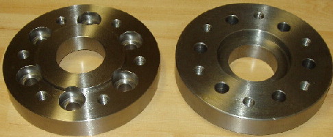

Well, I finally got rims and tires shipped up from Georgia...got them as a set on E-bay (and shipped here) for less than the 9.5 x 22 Firestone tires without rims. The side benefit is that the turf tires I have are now 14" wide instead of just 9.5" and they will bolt directly on my JD 4100 also if needed.
Instead of welding and drilling the center disc I had a friend turn some solid steel hub adapters. Here is a pic of the adapters before they were installed. I will try to downlaod the rims and adapters on the tractor also.

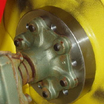

Here is a view from inside the wheels with the adapter installed.

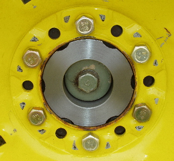

Here is a close-up outside view of the adapter and wheel installed.

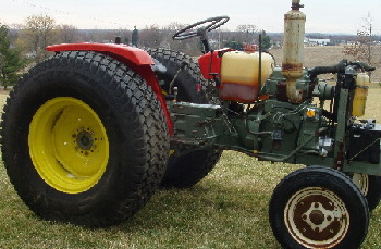

here is an over-all view of the new wheels on the tractor. Don't worry about all the missing sheet metal...I am starting to disassemble so I can repaint in the spring. The front rims will be improved also. The rear fenders DO clear but will be changed slightly to give a bit more room.

Those adapters are very impressive, nice job.
   / Value of rice tires and rims-plan a change to turf #16
BOY!! I wish I had a friend like that. If he wants any more friends give him my name. I would be available for adoption if he needs any more dependents.
