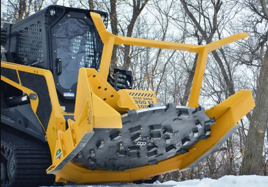

Well I was going to recommend Toolcat or a Versahandler, but they won't run a forestry mulcher.
They might run a disk mulcher: https://diamondmowers.com/products/skid-steer-attachments/skid-steer-forestry-disc-mulcher/
