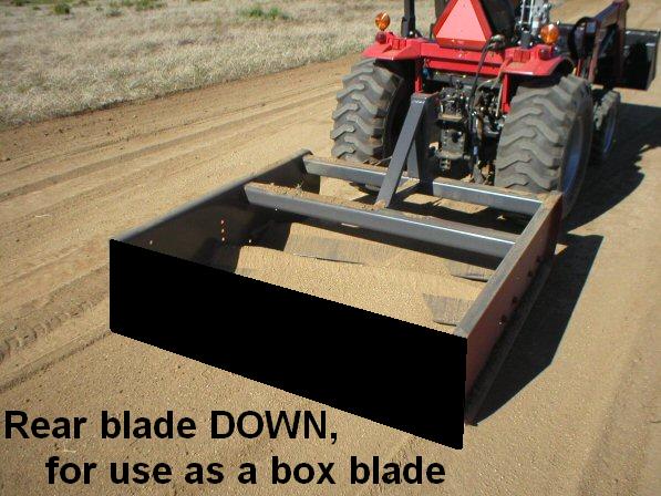

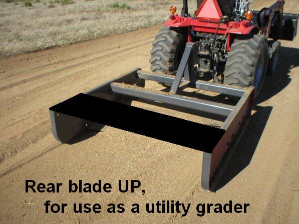

Just an idea:
How about a revision to the utility grader (land plane; road grader; road scraper; whatever they're called) to convert it to a combination utility grader & box blade. Add a flap / blade on the rear that can either be put up where it would lay on top of the grader's frame & the implement works as a grader, or down when you want to use it as a box blade. The flap / blade would be hinged, & you'd pin in it place in its down position for use as a box blade.

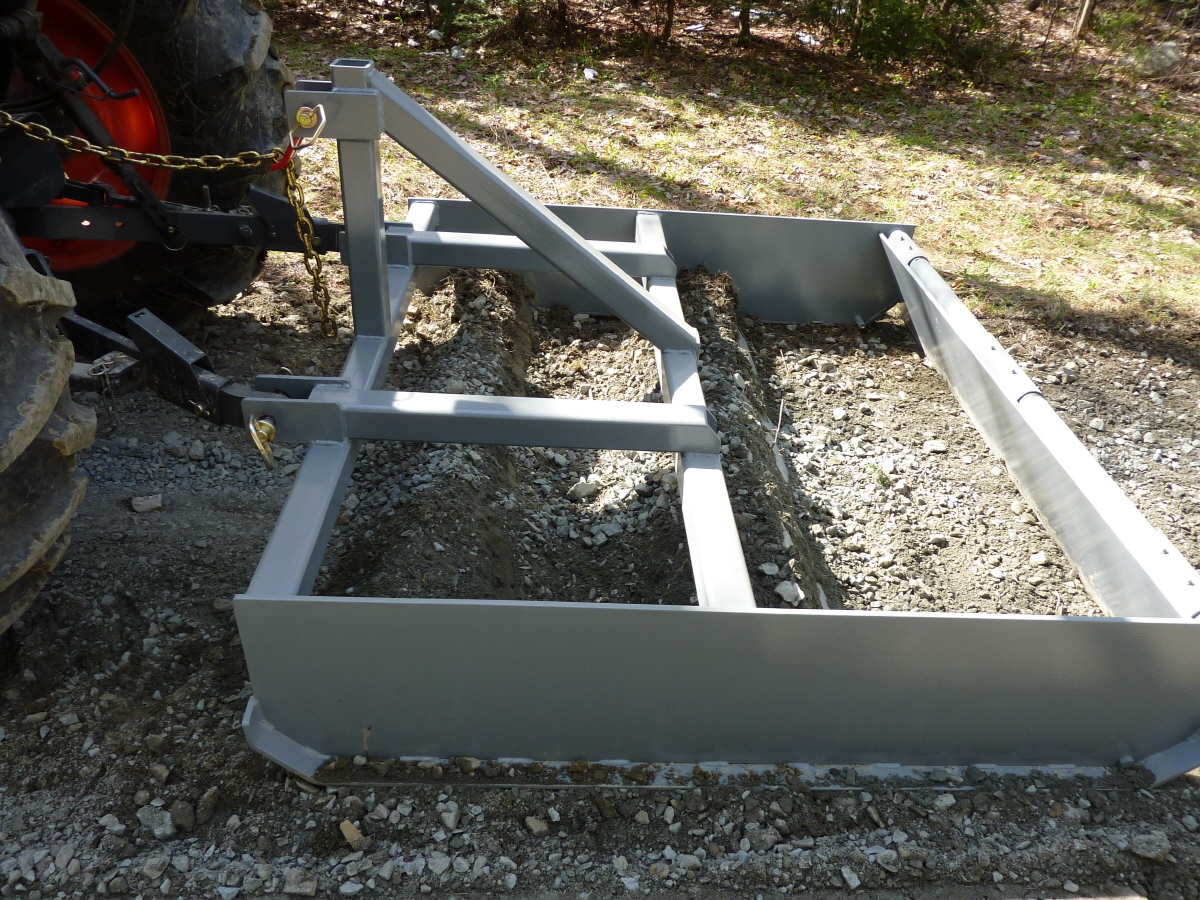

Thats what I did on mine. Not totally my idea though - I stole some of it from someone else along the way here on TBN. I have a pin one each side for tail gate stops. They are hard to see. If I put the tail gate inside it works like a box blade going forward and holds material in the box. If I swing the tail gate over the top and let it hang on the outside ( like in the picture ) it acts as a drag going forward or like a blade going in reverse so I can push stuff by backing up. If I get a pile of sod I just back into it to get it off the road.

I think that the rear flap like Gordon's is a great idea. I believe that there is at least one manufacturer that does have this as an option. One of the TBN members has one on order as we type. I am curious if it is going to be a gate as Gordon's is or if it might have a cutting edge on it. :cool: Hopefully we will find out in a week or two.

When I first did mine I was considering putting pins on top to hold it open and also a method of locking it in the down position. I decided to try it first then decide what I needed for improvements. So far ( one season ) for my use I like it as is. Althought neither of those things would be a detriment.
I use the box blade mode ( gate in front of the pins ) for initial spreading of new surface material or if I am working a place with rocks that are being turned up that I want to collect and get rid of. Need to set the top link just right to do this w/o getting to much dirt. Really need a hydraulic TL.
The addition of a blade or blades on the gate, as Brian suggested, would add versatility for sure.
