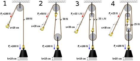

This a very complex system and it would be difficult to calculate. But say you have a multiple sheave pulley system. You input 100# of force on the first line. That same force is transmitted to the second line as it passes over the pulley. This happens at each change in direction. Then the magic happens. Say each sheave has 3 pulleys. Each pulley is exposed to 100# of force from each line. The sheave feels the 100# x 3 so the force is multiplied. That is how a multiple pulley system works.
Now I agree that if you put a line between the pulley and the object being lifted, that line and that line alone will feel the 300# force (same as the pulley)
Orezok explained it well. Here is a diagram that explains block and tackle (pulley system). The idea (with all simple machines) is that you keep the same work (force X distance). In this case much more distance (length) for less force. These were used a lot before we could use diesel and gas to do the work!

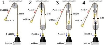

   / using your tractor to pull a tree over #53

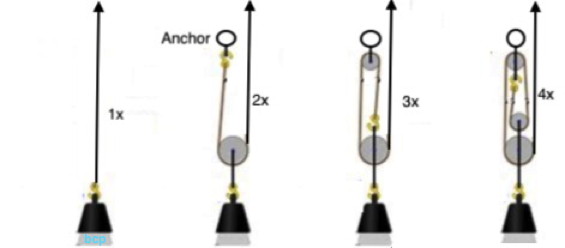

I've always thought those common overhead lift diagrams were misleading for someone trying to figure out a horizontal pull. For example, in the diagram above, the top pulley does nothing but reverse the direction of pull. It does nothing to increase the pull. It isn't need for horizontal rigging, unless you have to pull opposite the direction you want the load to move.
Simply count the lines pulling the load. In diagram 3 above, there are three lines supporting the load, so it is a 3x increase in pull.
