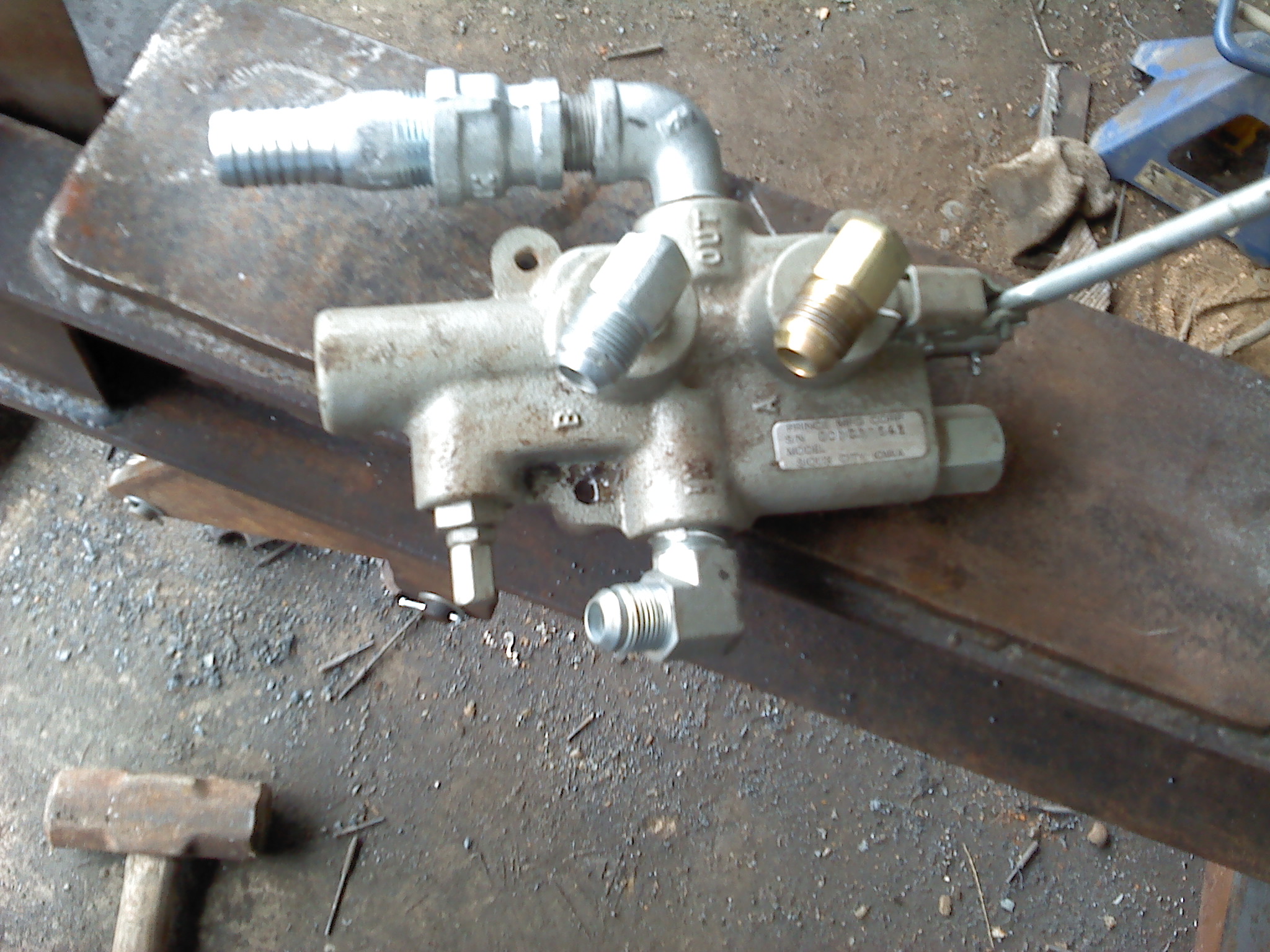

/ Using what I have
I understand that the splitter valve should return to tank. I am attaching another pic of the 3spool valve. I think this valve has PB, altho the only markings on the valve are inlet and outlet. There are two ports for inlet, and three ports at the outlet side. Currently the valve has a fitting in 2 of the outlet ports and one port is plugged. The inside dia of the fittings is 27/64 as evidenced by the drill bit I inserted inside the fitting to measure size. Just to note, all three outlet ports are directly connected with no type of divider between the three ports. This connection leads me to think this may not be a PB valve
Question 1, is this a PB type valve?
Question 2, if valve is power beyond, will fitting size allow for oil flow fo 10-16 gpm.
Question 3, if valve is power beyond, and will handle stated oil flow, would it work to place this valve in front of the splitter valve.
Of course, if valve is not PB capable, then the above 3 questions dont need answering.
Question 4, if valve is not PB, and I dont have a lot of cash to purchase another valve that is PB ready, We are back to using the flow divider valve. Would a ajustable flow control valve such as https://www.surpluscenter.com/item.asp?item=9-7960-12&catname=hydraulic work to divide the power between the two valves, or would I have to use a non adjustable divider control such as https://www.surpluscenter.com/item.asp?item=9-4158-2&catname=hydraulic

/ Using what I have #11
You should be able to remove the port that is plugged and look inside and determine if it is setup for a PB sleeve or screw to make the valve a PB valve. If you have two in port and two tank ports and have one port plugged, that could be your PB outlet.
If it has PB installed, you can use air to test the valve, and see which ports have air flowing when you activate the levers. PB will have flow with no lever activated. A tank port will only have air with levers activated, and you put air in the work port.

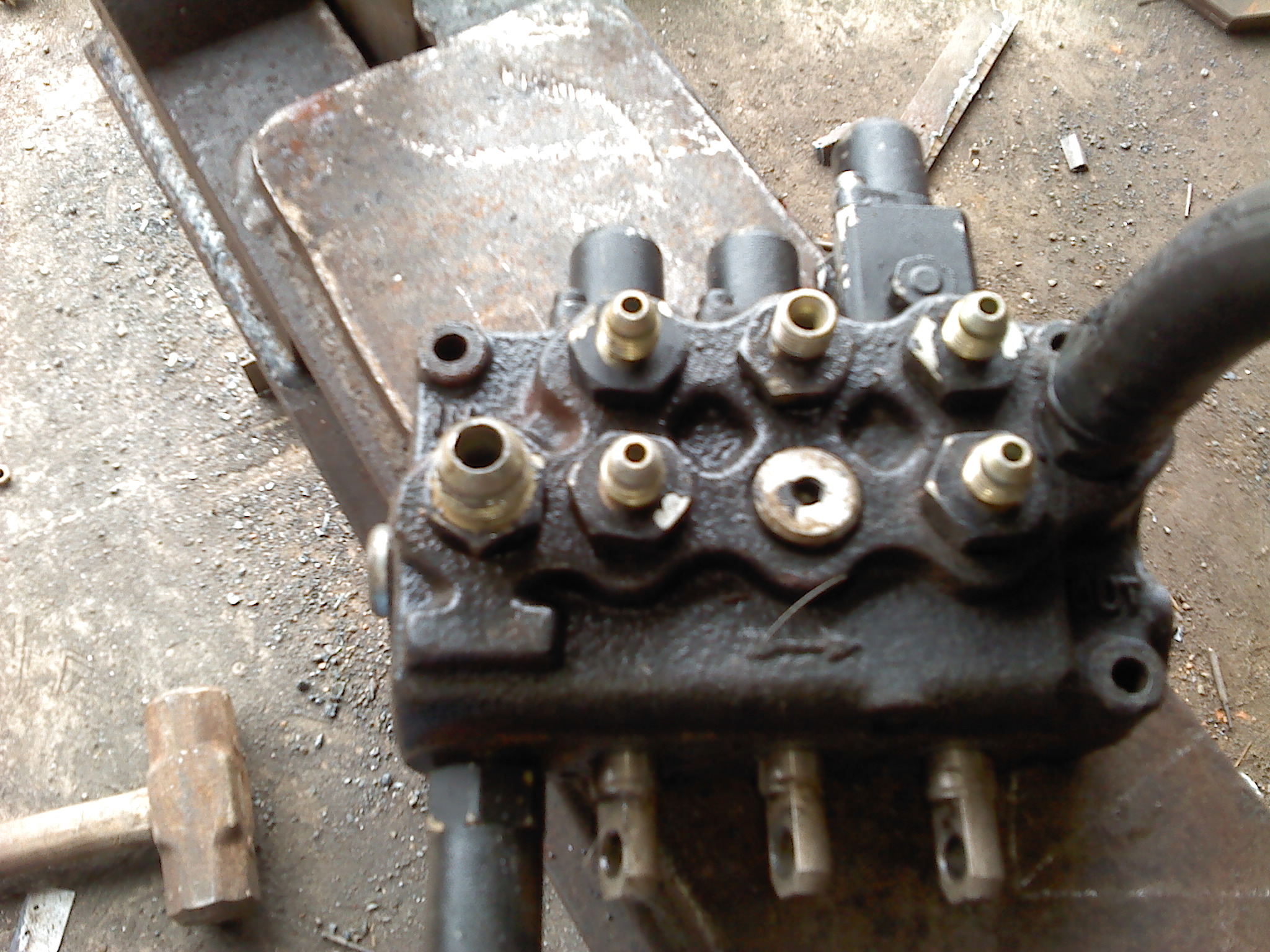

/ Using what I have
#12
The picture of the valve I posted looks nothing like the valve in your link. This make me wonder if the pics I am posting are even showing up. My valve is all one peice machined from one casting, it is not a sectional where each spool is its own seperate section.
Looking inside my valve, on the outlet port side, there are 3 outlet ports, two open and one plugged. I have removed the plug and all three ports are connected, I can blow air in any of the outlet ports and air will escape from the other 2 ports. I can stick a drill bit inside one port and see it in the other ports. I will have to look tomorrow and see if screwing a plug in one of the other outlet ports will block flow to one or both of the other ports, as suggested in your other link . http://www.tractorbynet.com/forums/...hd10-not-lifting-pounder-gresen-plug-page.jpg
Since there are two ports on the inlet side, side by side, is it possible that one port would be for open center and the other for closed center? I will attach a pic of the inlet side of the vale with both plugs removed.

/ Using what I have #13
Mudstopper,
In looking at the picture you posted of the 3-spool valve it is hard to determine if it has PB capability or not. From what you are describing I would say or not.
Another test with your air nozzle. Determine which tank port is common to pressure with the valves in there spring centered condition. Now shift one of the valves and blow air into the work ports of that valve. Does air come out the same tank ports? If yes it is not a PB configured valve. I do not know if PB is an option on that valve. Like J_J said, you will have to look and decide.
Yes this style of valve will provide you with priority flow adjustability. Just note, it also controls flow via pressure drop so I would expect around 100 -150 PSI loss minimum from this valve.

/ Using what I have #14
Your valve is a mono-block valve, cast in one piece, and bored out to certain specs. The other valve was in another post about a post pounder, and that port in question was a PB type port.
You generally don't see two ports side by side that do the same thing. If one of those ports is an OUT port, there is probably another OUT port on top somewhere. Might even be beside the IN port. Does one of the ports on the end have a machined lip inside. PB ports are usually in the middle of the valve end piece.
Some valves can be converted between open center valve which has on open center plug in a port, and other will have a closed center plug in the same port to make the valve a closed center valve, that same port can also can be a PB port by blocking the return flow from the cyl, and allowing fluid to pass through for downstream operation.
Since you don't know for sure, I think I would take it to a hyd shop and they probably have seen that valve before, and can advise if it is a PB convertible port, and perhaps where to get a PB sleeve or screw to make it PB.

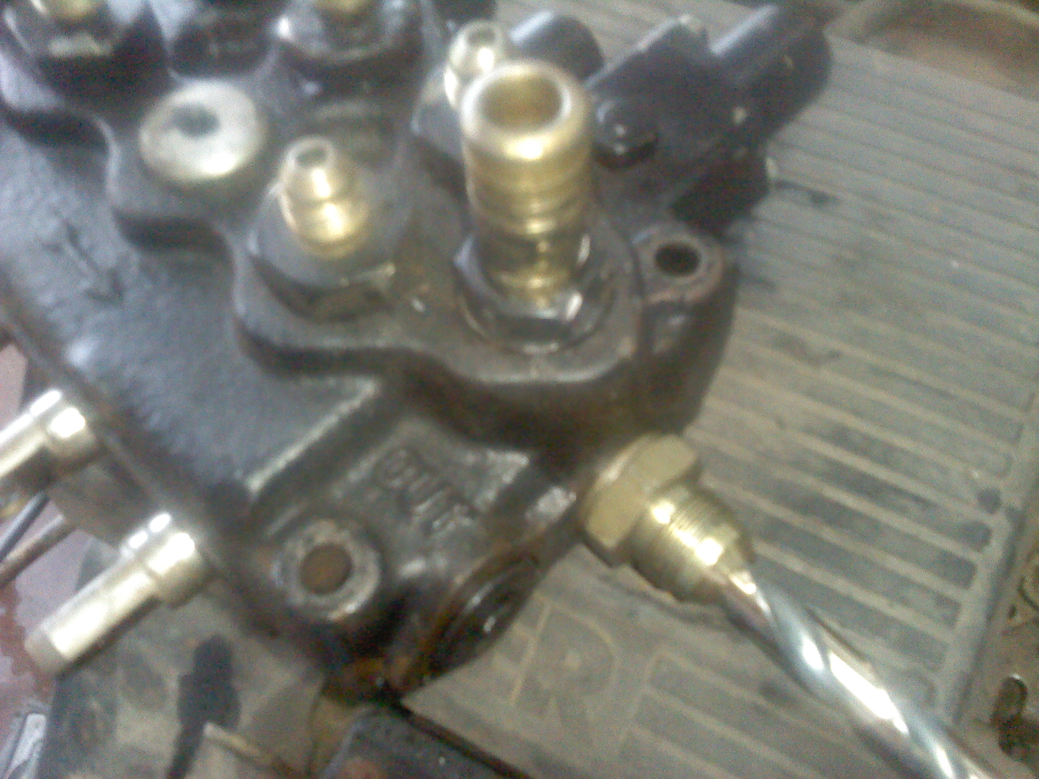

Can you take a pic of the fitting you took out of the center port with the drill bit in it? Could you also put some more light in the ports and take another picture using the macro mode on your camera.
Are you using the center spool for anything. It looks like it is set up for an SA cyl.
You have 11 ports on that valve.
pressure ports =2
Out ports =2
work ports = 6, 1 is plugged
1 port = probably for PB
I believe someone was using the top side of the valve for the IN and OUT port, so it is a good bet that you have a PB port. It may be plugged with an open center plug. If that fitting has an o-ring and is deep, that is an indication for PB.
When they use a port for conversion, they use the same port for open center, or closed center or PB.

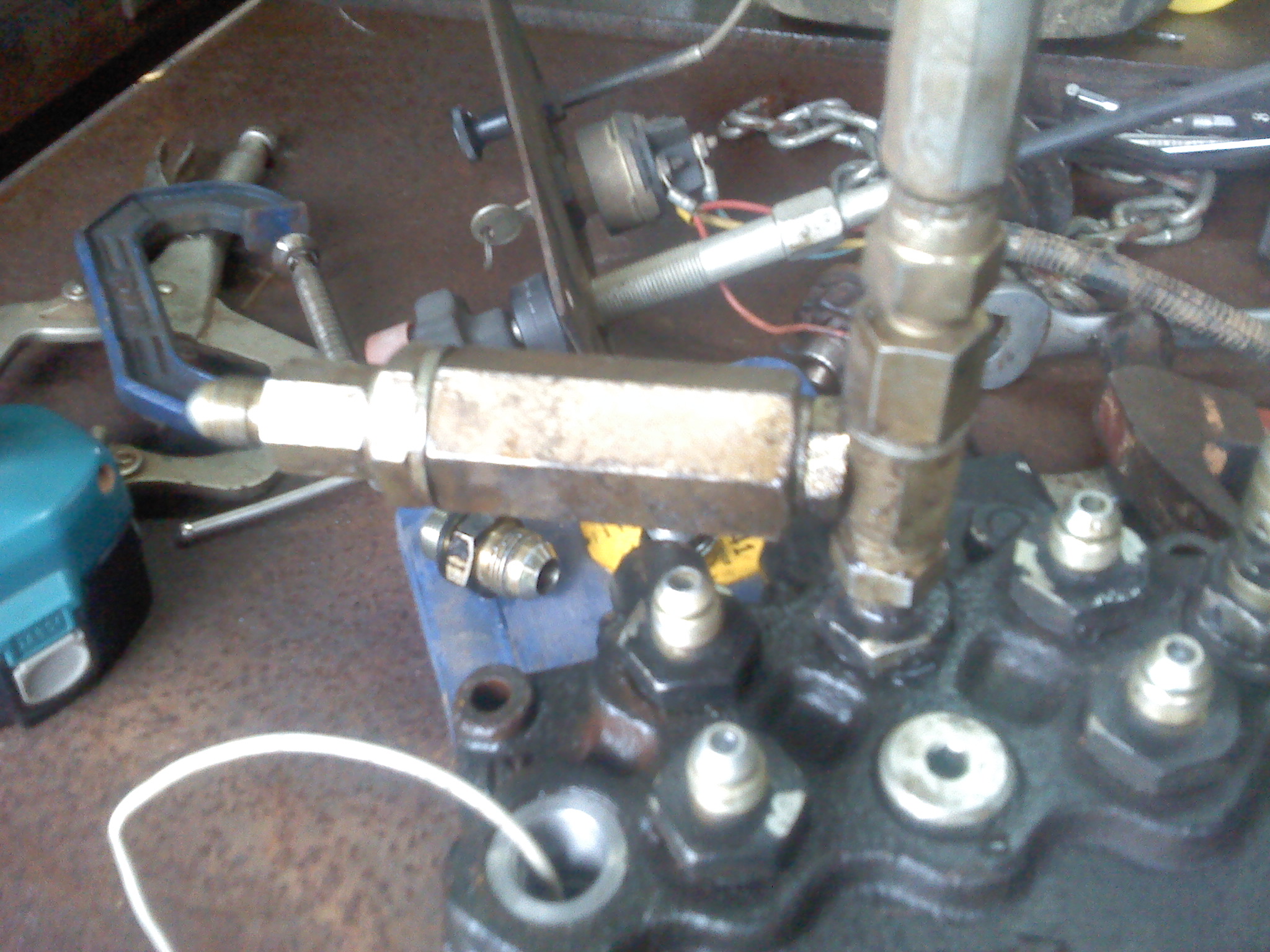

/ Using what I have
#19
When I started this project, i was only going to split wood and use a moveable 4way wedge for splitting, so only two functions where needed, To much time on my hands and a little tubing later, I decided to make a boom to pick up the large round to place on the splitter, so function #3. Not willing to leave well enough alone, and since I had the cylinders off the long arm, why not make a knuckel boom, function #4, which puts me at the limit of my combined control valves. Since I have also decide to use the stator rotor motor I have, I might as well make the boom swing under its own power, so now I am up to function #5, No valve so this function will have to wait. Of course with a knuckle boom I might build a grapple, function#6 and make it rotate, function#7. Outriggers, functions #8 and #9. And to think, I started out only wanting to split a little firewood.
Money is a factor right now, so i am thinking about just removing the boom and going back to my 2 basic functions and it seems I dont even have a PB valve to make that work.
I am posting some more pics of the 3spool valve in question.
First pic is of the outlet port side of the valve. As you can see, I put a red test probe inside the top port that can be seen in the right side port. On top of the valve you can see the plug that came our of the left side port, and the fitting that came out of the right side port.In the second pic, you can see the 2 side outlet ports with a white wire running thur the side of the port to connect the two. The third pic is of the lefthand side port that had the wire running out of it. Inside the port it is had to see, but the narrow dark colored band on the right side wall is what connects the 2 side ports.
The fourth pic is of the top of the valve showing the check valve that was attached to the middle spool.
Here are the results of the air nozzle test. Blowing air thur the inlet port with all spools centered, air moved unrestricted thru outlet ports. With spool shifted, air from inlet port would blow thru one side of the work port only. Blowing air thru opposit work port, air would blow thur outlet side of valve only. If spool is shifted in other direction, air flows are also reversed.

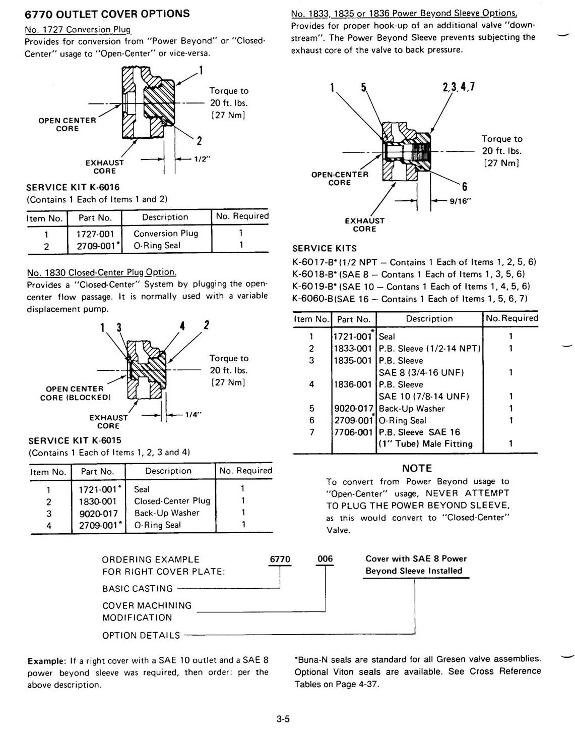

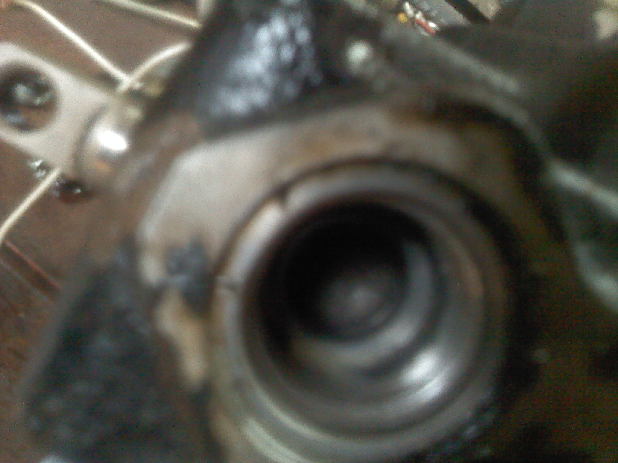

/ Using what I have #20
Your camera must not have a macro mode, close up mode. I still can not see inside the valve good enough to determine if the port is PB capable. I am looking for the indent like where the seat of a PB sleeve might fit, or a closed center plug might fit also..
Was there another valve connected to this valve, and if so , what was it's function. I don't believe they would have used two OUT ports.
My point here is that this valve seems to have three out ports here, and that is unusual unless one of them is PB capable.
That spool setup for SA can also control a DA cyl by removing the plug and using that port for the cyl.
Use this page as a ref, see if you can visualize a lip that would allow a sleeve to block fluid in the exhaust cavity, and only let fluid out from the core through a channel in the sleeve, otherwise, pass through fluid for downstream operation.
