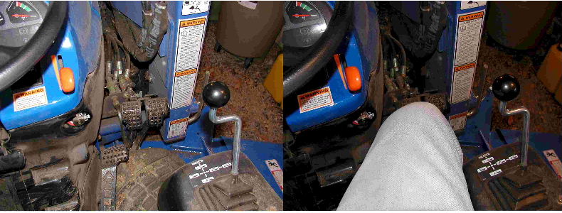

Hmm, does look a little difficult to get off that side.
Hope you don't mind, but I took the liberty of scaling down your picture.
   / using rear remote hydraulics for a loader #12
<font color=blue>Hmm, does look a little difficult to get off that side.</font color=blue>
Yep, with the HST pedal and the FEL control, it's a tight fit, which is why I always exit to the left. I suppose if the FEL controls were on the loader upright there'd be more room, but I think having to reach out to the controls would be much less convenient.
<font color=blue>Hope you don't mind, but I took the liberty of scaling down your picture.</font color=blue>
Don't mind at all. I forgot to do that before I posted.
   / using rear remote hydraulics for a loader #13
Mike, I'm really glad you posted those pictures. I wasn't completely sure how much modification it would require for Mosey to use the rear remotes, but your picture shows the loader quick-connects are mid-mounted just in front of your hydro pedal. If Mosey wants to use his rear remotes, he will have to provide extra hoses with female quick connects on one end and males on the other. In addition, he would have to find a way to route those lines so they would stay out of the way of the 3PH and the underbelly mechanincals...not to mention ensuring they aren't handy for brush to snag. My point is that he would probably spend as much money rerouting the lines as he would to buy the factory joystick control for his tractor. If the joystick handle is in a bad location, I think I would look at getting someone to put a couple of additional bends in the handle, or maybe get someone to completely fabricate one that is not so easy to bump when exiting to the right. Do you think the handle could be shortened? Would it be much harder to operate? ...just my thoughts.

The piece that intrudes on exit space is the black plastic cover that conceals the hydro connections to the joystick. This cover drapes down the fender reducing egress space. Modifications to the joystick itself might help a little.
Your comments about rerouting hoses are excellent.
