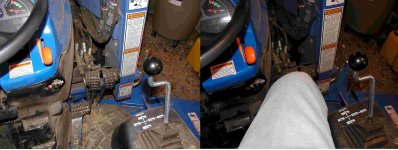

   / using rear remote hydraulics for a loader #10
Danny, perhaps this picture will help. The steering wheel is in the full up position.
