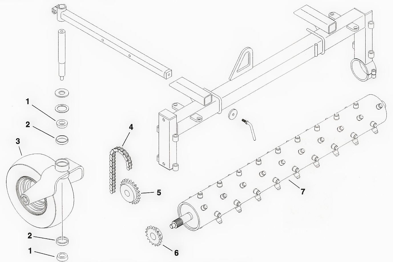

just did a picture search, as I did not know what a Harley rake was,
came across this web site Harley Rake, Tractor PTO, T-6 Series 6' Power Box Rake picture at bottom, of page, but one can see they used about 6 to 8 inch pipe about 1/4" wall had two donuts turned of steel and put a shaft in and welded it up,
I took a part a old sugar beet toper, basically a huge flail mower, and the main flail drum was a heavy pipe with ears welded on it for the flails (I took that part and planted it so the cows had a scratch post).
pipes are used in that manor a lot, a two end pieces and some times, a unit cut for the center support, if welded it is usually plug welded, and a shaft for bearings extended through the middle of the pipe, and welded to the supports
another site drawing is from is from one can see by the drawing it is a pipe
/ Using Pipe as a shaft? #6
could not get a second picture to take
