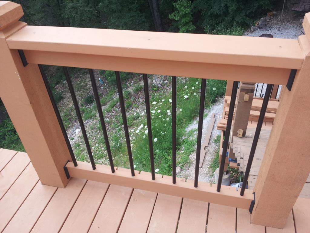

Lowes and home depot sell powder coated aluminum balusters just for this application.
They also have black plastic brackets to mount the bottom supports in. We thought
they dressed it up a little.
