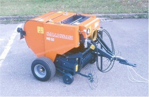

/ Using implements from diffrent tractors?
Hi Just found a pics from the small bale machine, it needs 11-15 hp 80cm wide. The bales have a diameter at 57cm and lenght 63cm
I think its made in Italy.
/Sam

/ Using implements from diffrent tractors? #11
that is cool ... how much $$$$$?
/ Using implements from diffrent tractors? #12
I don't have a clue, but that must be one HECKUVA friend to try this with your BX.
At least it is the correct color....
/ Using implements from diffrent tractors? #13
Most of those little balers are super high in price. I've seen them asking $10-$15k for them new which is crazy as you can buy a brand new Vermeer 5410 rebel 4'X5' round baler for $14,000. Looks like it would be a big pain in the neck to me, having to work with stuff that small, but I guess if it is all you had to work with, more power to ya.
/ Using implements from diffrent tractors? #14
The Star equipment is expensive, but it's good stuff. I did a demo of the mid-size round baler and the B size Kubotas are plenty to run them. Wouldn't want to get into hilly ground with them, but size to power, they're fine for small tractors. Take a look at some of the pics on this site.
Small Farm Innovations
/ Using implements from diffrent tractors? #15
That's cute as a dickens!! Size is only a rough 24x24 bale. Should have any problems with that baler.
/ Using implements from diffrent tractors? #16
That is a cute, baler! Why noy just take a regular bale and split into thirds, tie with some twine and be on your way. I know that's not the point of the post but seems silly to have a special unit for tiny bales. I guess though must be a market for it somewhere.
