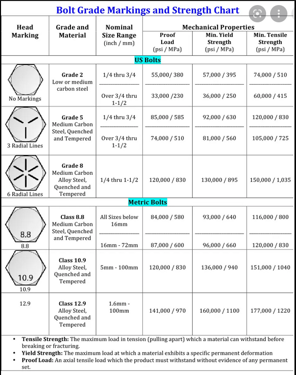

I was looking for grade 2 but only saw grade 5 and 8 clearly marked. Are grade 2 bolts typically not labeled with a grade?
Yeah, grade 2 bolts are typically not marked. You can tell they are grade 2 because they will be the cheapest.
That is correct.... grade 2 is usually unmarked.
Eric
Thanks. I never knew that they where called Grade 2. I just assumed that they didn't have a Grade to them.
I also don't really know what Grade means, other then Grade 5 is stronger then the bolts with smooth heads, and used for sheer pins, and that Grade 8 is the strongest that I can buy at the store, but they are too strong to use for sheer pins.

Maybe the chart below will help you understand differences in bolt grades.
