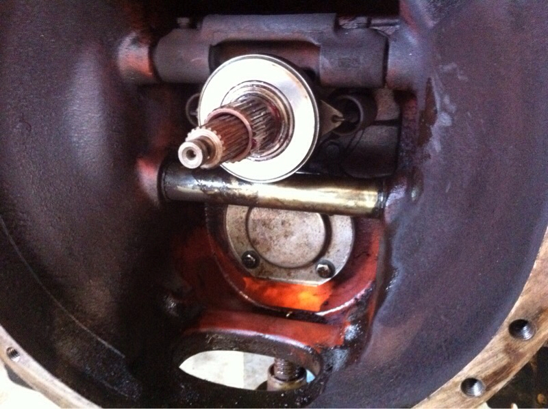

I have a feeling this thing hates life and isn't longed for this world.
