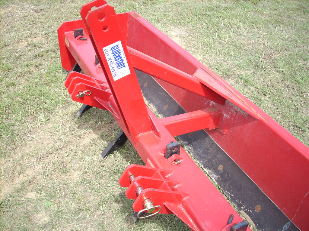

You could modify the cat 1 implements to clevis mounts so they had two hitch points:

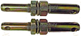

Or change the single mount to use a dual category pin:

Other options:
Bruce
Now we're talking. This the perfect fix/modification.
I modified two CAT I attachments to fit CAT II QH using that method. Works great. I can use them with my CAT II tractor and my Brother can use them with his CAT I tractor. Both of us using QH's.

ovrszd & bcp
Modifying the implement to accept Cat l & Cat ll was not in the thread title. I will refresh your memory on the title of this thread """Re: Using Category 1 and 2 Equipment With the Same Quick Hitch""".
These Cat l/Cat ll pins in your photo will not transform a true Cat l implement into a Cat ll without the aid of a welder
Anything can be ACCOMPLISHED with a welder/cutting torch and a very experienced operator!!!!!!!!!!!

gwdixon, that's slick. Didn't know they offered those. That definitely solves that problem!!!
TxJim, that's what we are saying, modify the attachment with clevis brackets and you can pick it up with either kind of QH. And the modification can be done on a factory CAT I attachment or a factory CAT II attachment. Problem solved without any kind of hack job.
Modify the attachment with the pins, CAT I turned in, CAT II turned out and you get the same result.
It's just stronger to create clevis brackets.

I'm just trying to get the OP's original question answered CLEARLY.
I thought the question was "will a Cat l QH fit both Cat l & Cat ll implements" or "will a Cat ll QH fit both Cat l & Cat ll implements" not can a QH be modified to fit both Cat l & Cat ll. Normal Cat l hitch pin points are 26" apart & Cat ll hitch pin points are 32" apart. Installing the pins in the photo is not a simple bolt in on Cat l implements as the Cat l ends will be TOO CLOSE together for a QH IE Cat l pins will be a lot less than 26" apart.
