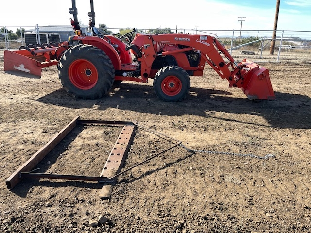

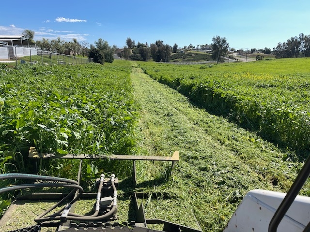

Removing the rocks may be an option. I have a 5 acre field like this. First mowing cost me a set of blades. I disced, smoothed, and removed the surface rock, 3 buckets from 5 acres! The second cut was nice only one rock jumped up at the blades.

Your fortunate only 3 buckets on 5 acres - here they push up a new crop every winter so either fill and level soil around them or dig them out.
What's that you are dragging - looks like a FEL bucket or is it a grading device with slots to catch rocks?
   / Using cable or chain instead of blades on a riding mower #9
Last yr I ended up dragging the heavy MX bucket over this disced field to smooth it out so I could mow the field this yr. It did a pretty good job of moving the big stuff. I ended up throwing something together for a final pass and it looked pretty good afterwards. Rocks were collected the old fashion way, manually. Mowing that field is now possible after a lot of prep.
