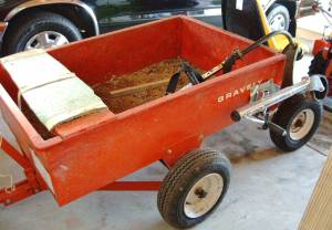

No, by mounting a guide wheel to the side of the cutter, you allow it to push the 3 ph up (where it'll easily move if left in neutral) when the guide wheel touches ground. Could put the 3 ph lever all the way down and let the guide wheel determine where the front of the cutter runs, the 3 ph hitch can run up and down then independent of the rear wheels. Not sure how well level the cutter would stay with a guide wheel on just one side though.
Here's a pic of the big castor wheel that's mounted now on my Gravely cart (that I never use now). It's rotated to where the castor wheel is horizontal and out of the picture. This is the one that I've in mind to put onto the cutter.
Ralph

Hi Ralph,
Thanks for the interesting idea, but I just wasn't using the Bush Hog properly. Greg G's explanation of how to adjust the Flex Link worked well and the mower is now doing what it's supposed to do.
Thanks again for your input and help!
