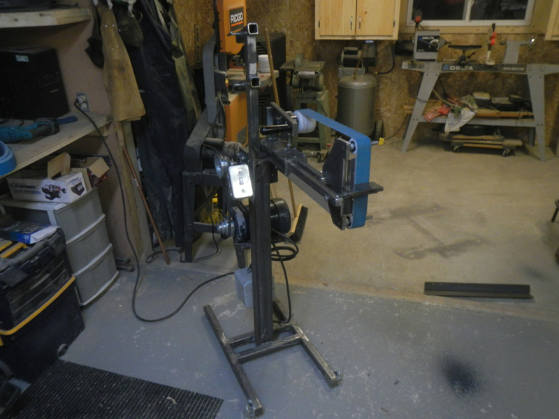

I built a KMG clone 2" x 72" belt grinder last winter. It does a great job at rapid removal of material without over heating the part. The problem with disk grinders is they have different surface speeds and can cause more stock to be removed on the outer edge vs the center of the disk. The belt grinder does a better job at sharpening various cutting edges than either the disk or bench grinders.
Sfrankland, did you have a plan for your grinder or did you just build it from seeing other grinders?
About how much do you have in it?
PS - It looks great.
/ Using a Bench top disc sander #10
Plans for the grinder can be found here.
http://www.metalwebnews.com/manuals/knife-grinder.pdf
I used the plans but made some changes like the tool rest is independent of the arm that holds the platen, added a gas strut instead of the spring and other small changes. I am running a 2Hp motor wired 220 Volt. The steel is all new, the motor and wiring I had and the wheels I had made by a machinist friend. All said I have about $300 into it.

Really like your grinder. It am guessing with the 3Ph motor you are going to run a VFC to be able to control the speed.
/ Using a Bench top disc sander #13
Yes, that is correct. I already have it wired and running, I just need to get the pics up-to-date.
