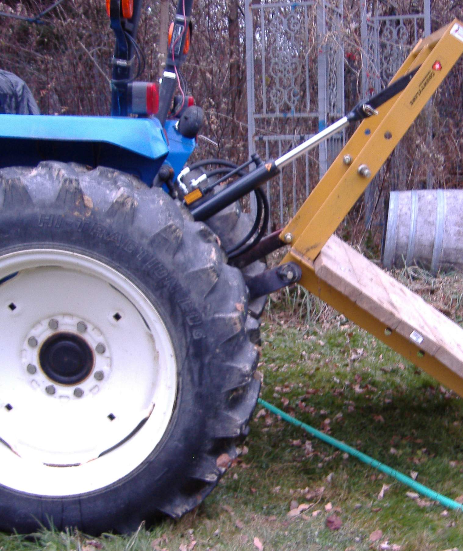

I still prefer the hydraulic toplink. I suppose a winch could work as well. All of the steamshovels of the past worked on cable and winches.
