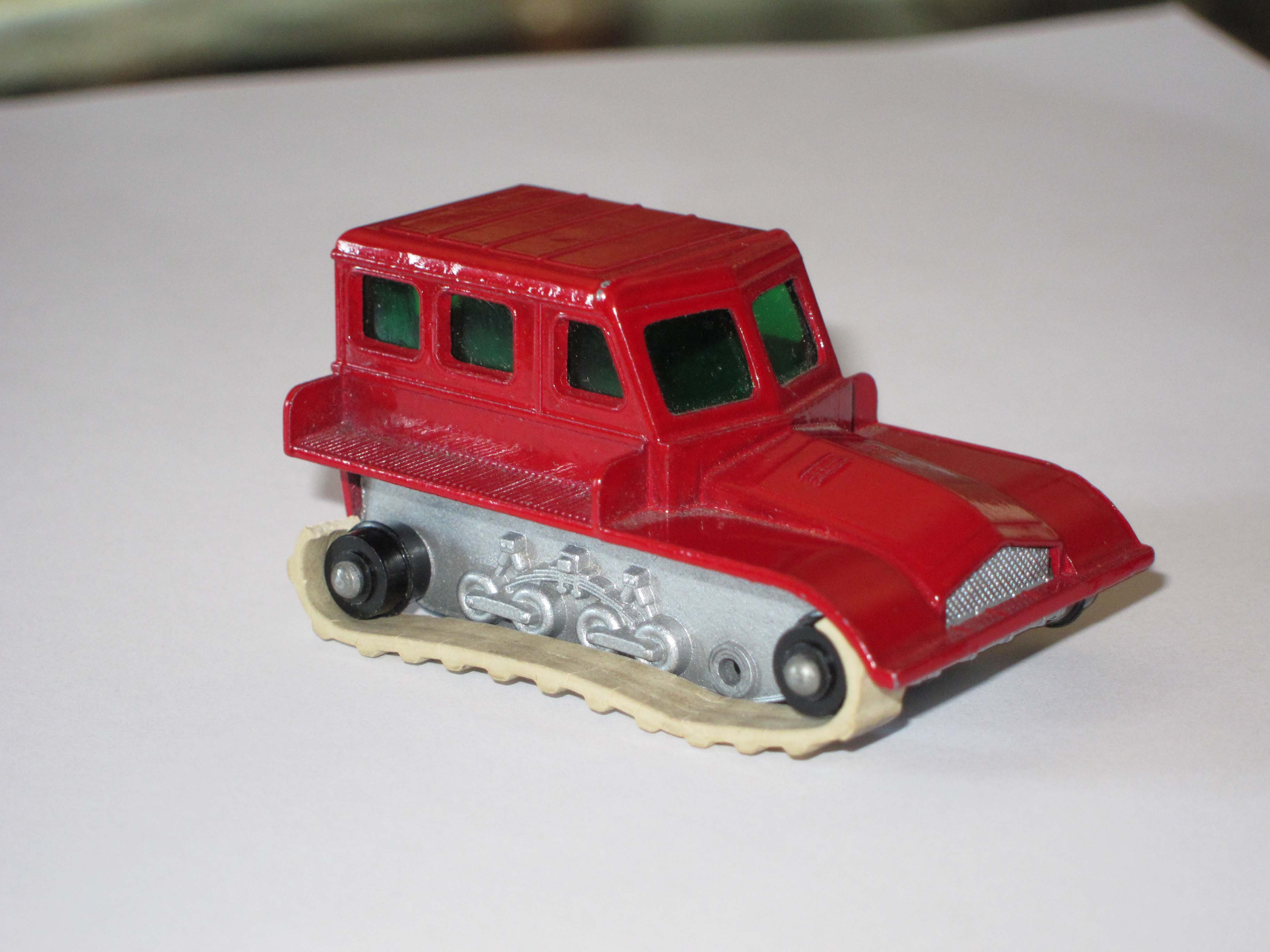

I still have mine. It's only about 45 years old. It's in good shape except the trac is dry rotted.
