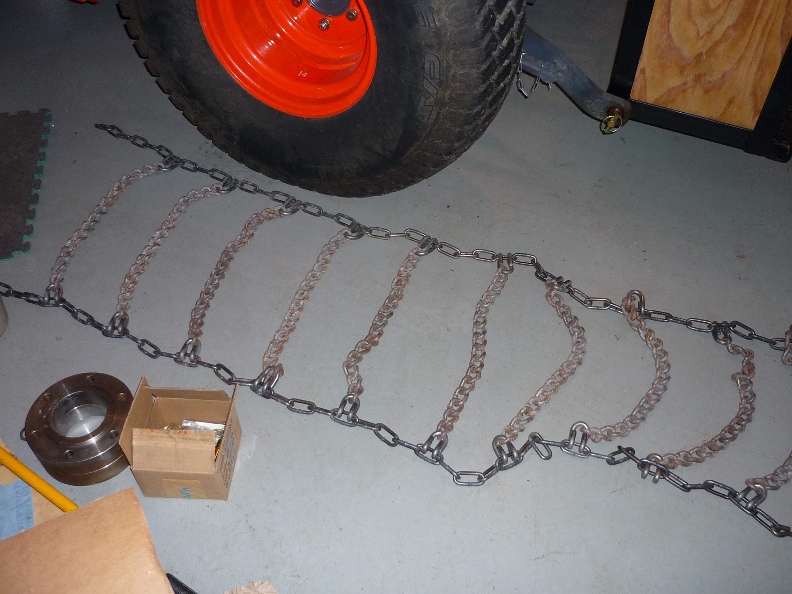

Take your tape measure and measure the circumference of your tires, and get an idea of distance of the width you want. Chain companies will spec. the length and width of their various chains. They are fairly easy to shorten, using a vise and some pry tools and a hammer to close links, and I have even narrowed some, but that takes more effort. Keep in mind that when you shorten chains, the spacing of the cross links may not be come out perfectly, leaving an open spot, which usually doesn't really affect operation, but doesn't look "perfect". Photo shows some LaClede ladder style chains (turf tires, so I don't need duo-grip) that I shortened considerably, but they were close-out priced ($100 +-) from a dealer that had gone out of business, so no big deal.
