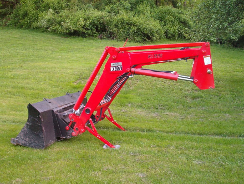

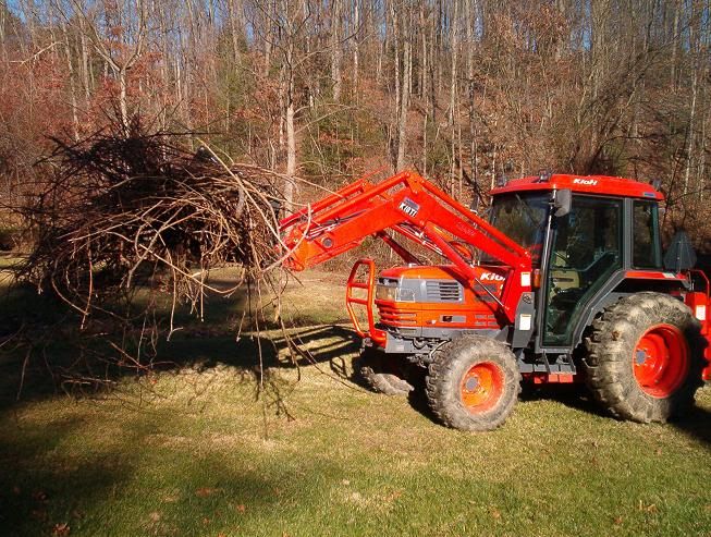

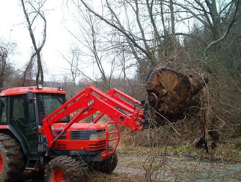

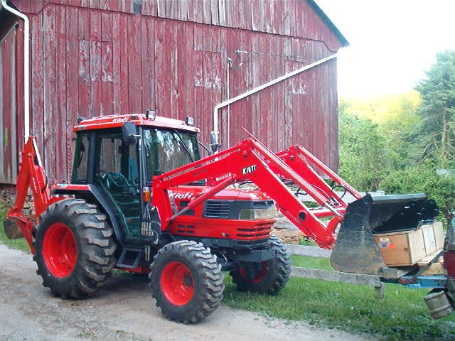

Donegal, Go look at the Kioti I think you will be impressed with it. Although its only has half the hp of your Same 100.4 (nice!). I have a DK50C with the KL1590 loader. Had it 6yrs and 700+ hrs and still looks and works like new. It lifts anything I try and if its to heavy it will lift the back tires and backhoe off the ground. Mine is a 2001 model USA made at Kansas machine works. the picture you have are different (European ?). The USA models had the rollback issues.
Kioti offerd an upgrade kit #1590-2035 it fit the 1590 and 1595 and included a quick attach or weld on bucket kit for around $1100. it came with new cylinders and linkage. Most of the rollback was in the new angle of the pin holes on the quick attach. The 1590 and 1595 were the same loader only differance was where they attached to the tractor.
I just love mine it is very strong. Originaly I modified mine for more rollback then in 2007 I purchased the upgrade kit (the one you are looking at is different and you wont need an upgrade). In the later years 05-07 they came from the factory with this upgrade and were labeled as 1590s and 1595s. Do a Google image search under Kioti KL1595s and you should see results.
I have done a lot of research on Kioti and these loaders I stop and study every one I see. They are very stout and strong loaders. All Kiotis I have seen use a center mounted remote for hydraulics not the rear. I also use a Weareduction grapple on mine and it works great. I hope this helps keep us posted and get pictures when you look at the tractor
Frenchie
Here are some pictures of my 1590 loader.
