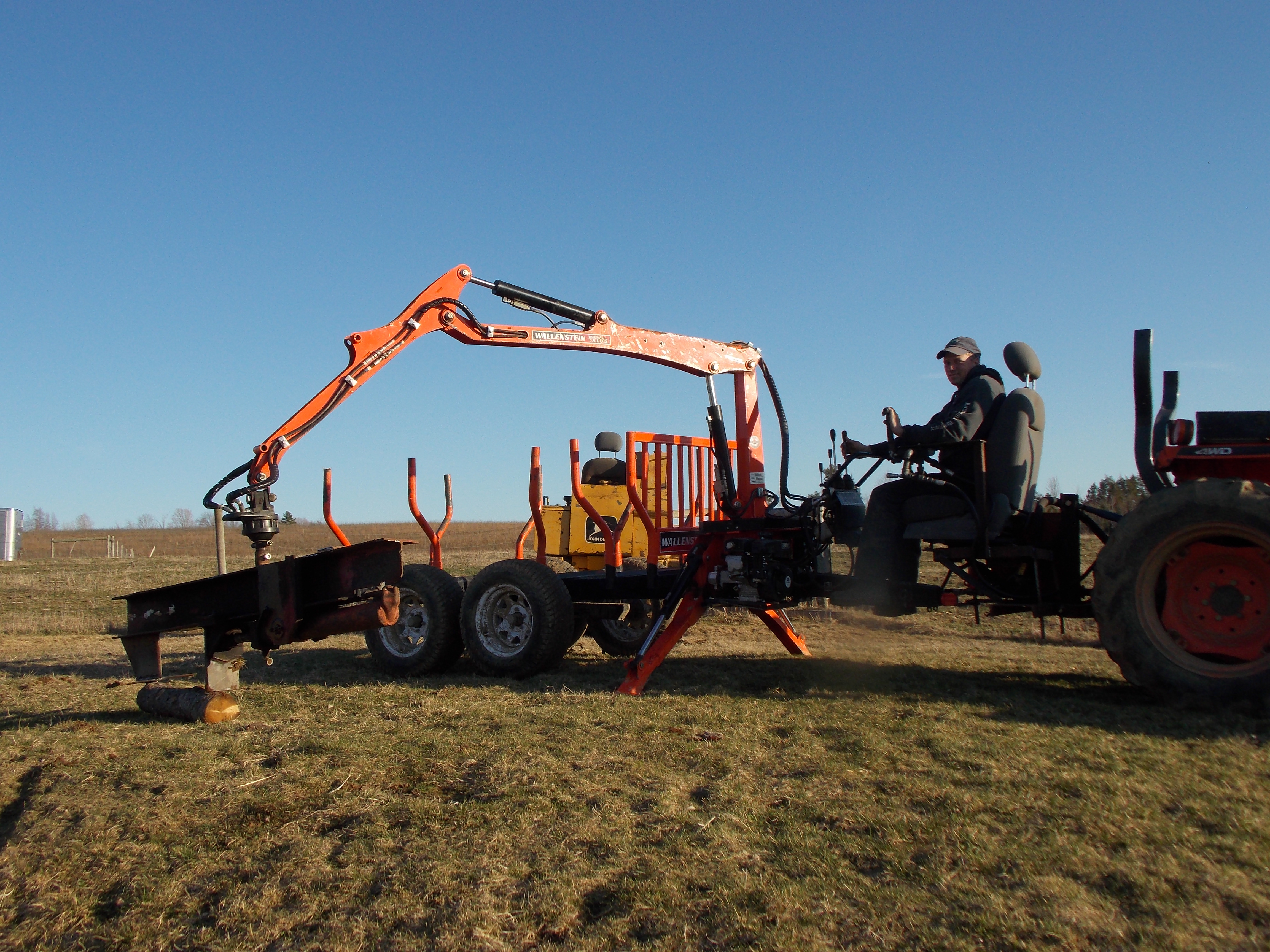

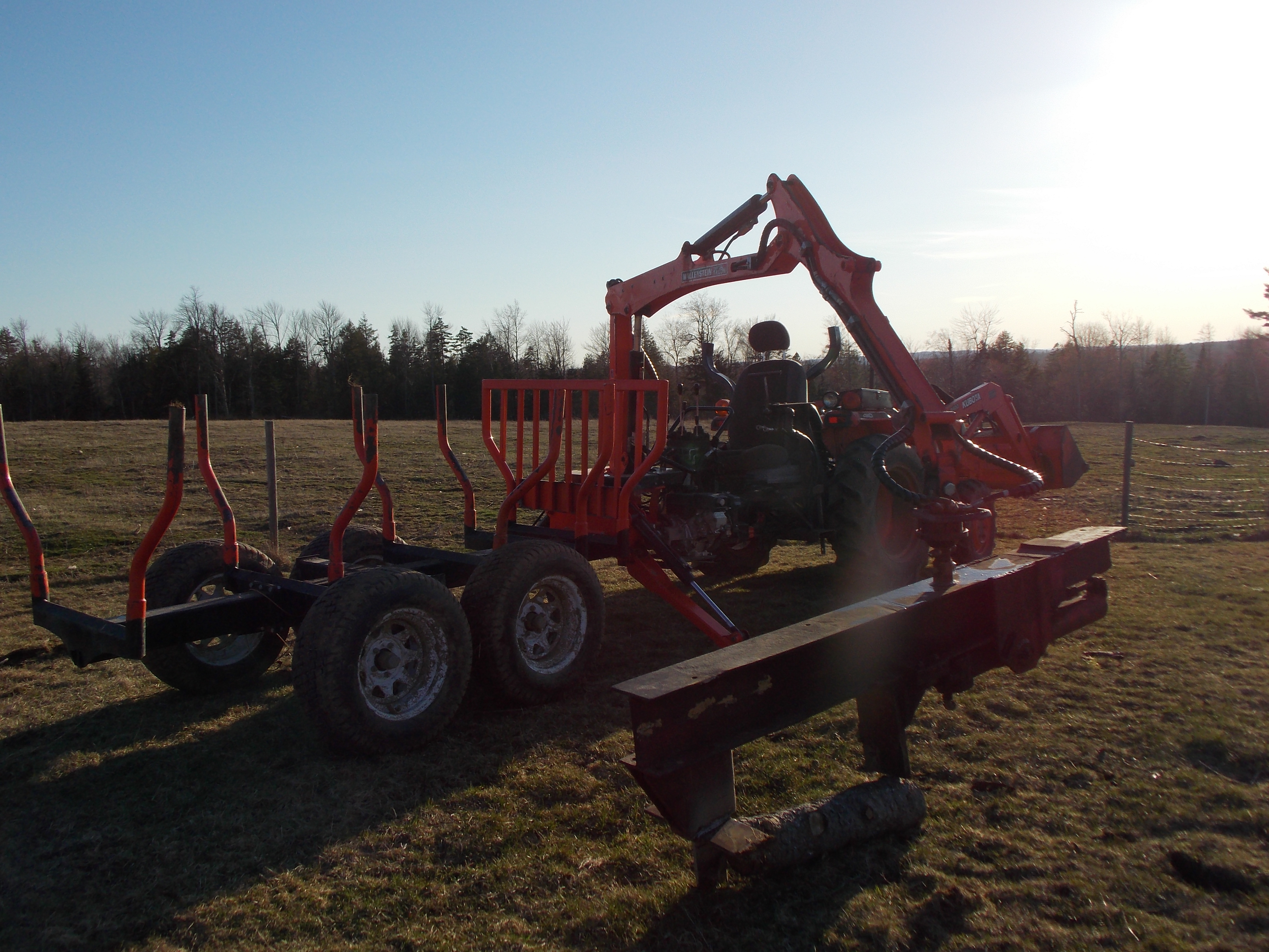

The older I get, the lazier I have become, and that applies to splitting wood. With a little thought I realized I could put my log trailer to use and build an upside down woodsplitter so that I could sit on my bottom and just run levers...and yes my new woodsplitter has a cup holder! The fabrication was kind of intense, but I will try and breeze through the text so you can see it in the photos.
Basically the woodsplitter comes in two parts; the "carrier" and the woodsplitter itself.
The carrier is where I mounted a pto pump onto the tractor, then fabricated a carrier to mount to the 3 point hitch which would hold the hydraulic reservoir tank, a seat, and a hitch for my trailer. The seat came from a Ford Focus and has all the adjustability: forward and back, recline and even lumbar support! Basically I used a PTO pump so that the woodsplitter was detached from my log loader hydraulics (which has its own separate engine and hydraulic system) so I could get more flow.
On the woodsplitter end, I mounted it to my boom so I get 365 degree rotation, and added a 4 ways splitting head.
In operation I just use my log loader to hover the upside down woodsplitter over the round of wood, pick the round up by pinching it, but not completely splitting it, only doing that when it is over the dump body of my log loader, over my pile, or over another trailer or dump truck. (My bunks can be removed and a dump body put in its place).

I had all the parts kicking around so it was a cheap build, but now that I have proven it works, I might build a new splitter head for it and make it lighter in weight. My loader can handle 800 pounds, but a lighter splitter head would be easier to navigate into the wood pile.

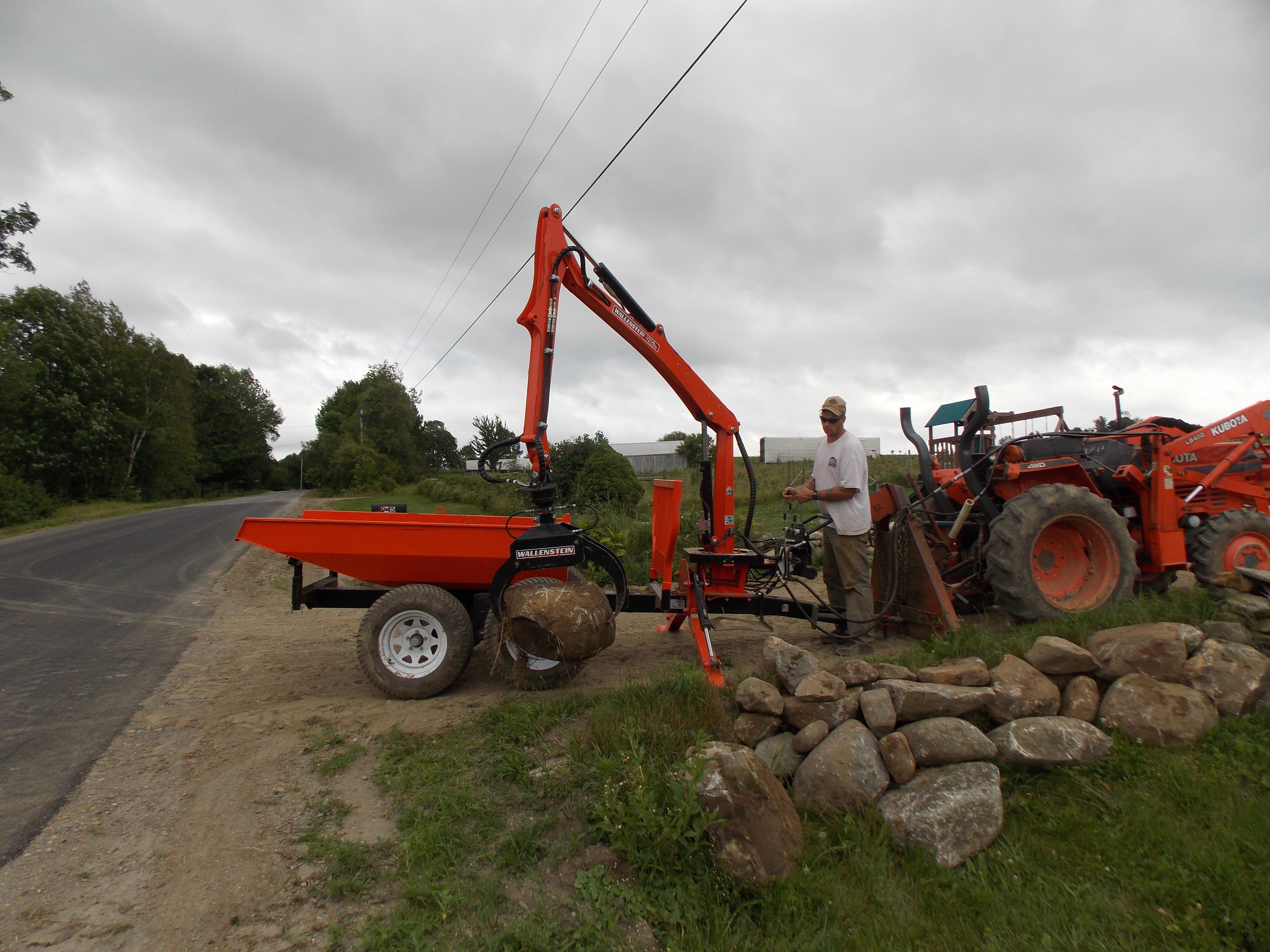

I do not have a photo of the upside down woodsplitter with the dump body on it, but I do have one of the dump body. It is kind of small so for firewood I would add sides, but it can at least be dumped.
