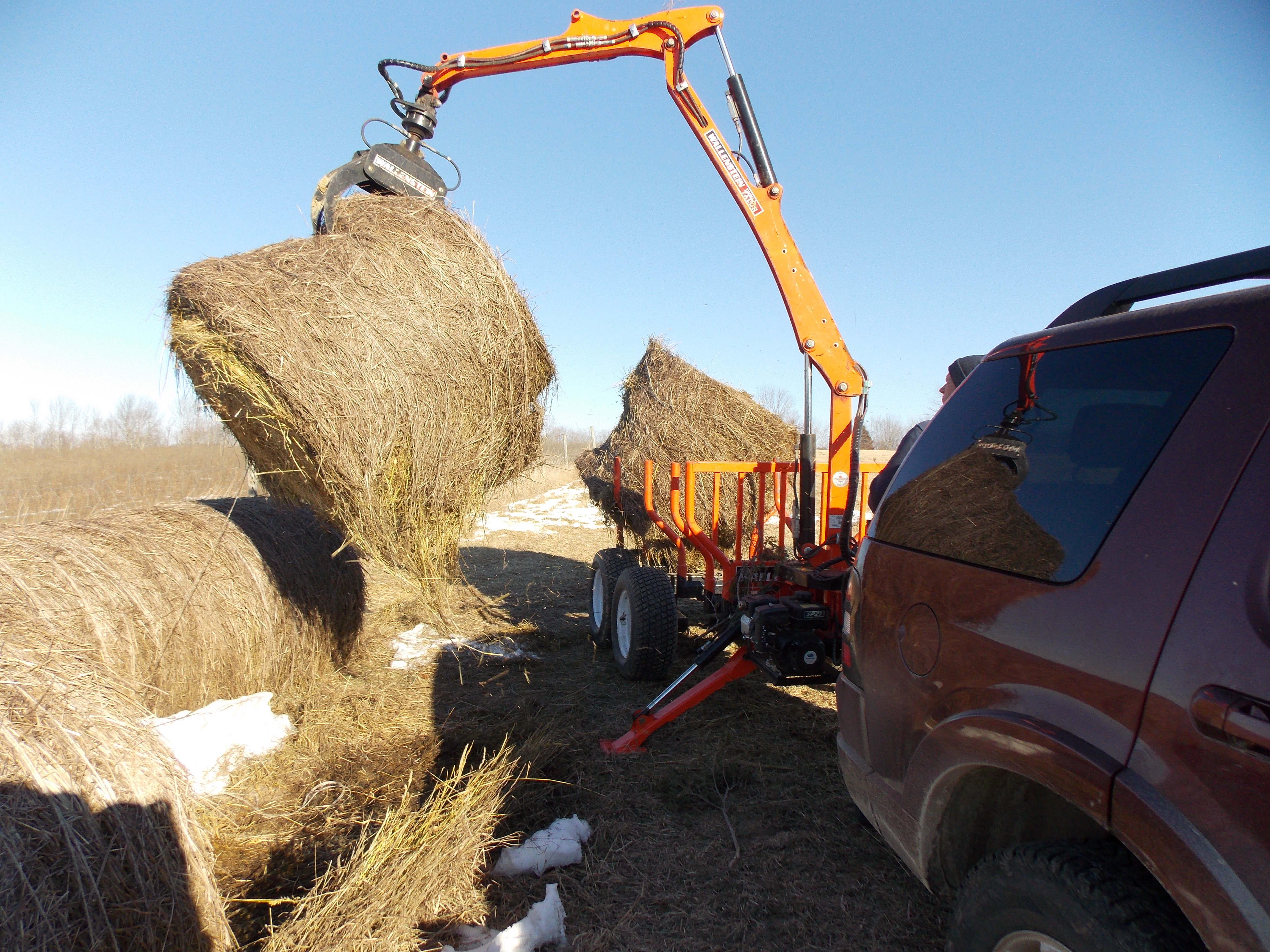

I actually thought it was the other way around. I thought they were pricey and the others were inexpensive and made to match. I am hardly brand loyal, I just thought I over-paid for this machine.
Not that I am not happy with it. In a years time it has paid for itself. I am happy with that, and keep finding things to add to it to make it rather a Swiss Army Knife on this farm. Surprisingly the thing I use it the least for (logging) was the reason I bought it.
I lost the market on 8 foot pulpwood so I have been doing tree length wood with my skidder instead, but this time of year, moving round bales for my sheep is a big help. It is really fast at doing that.
